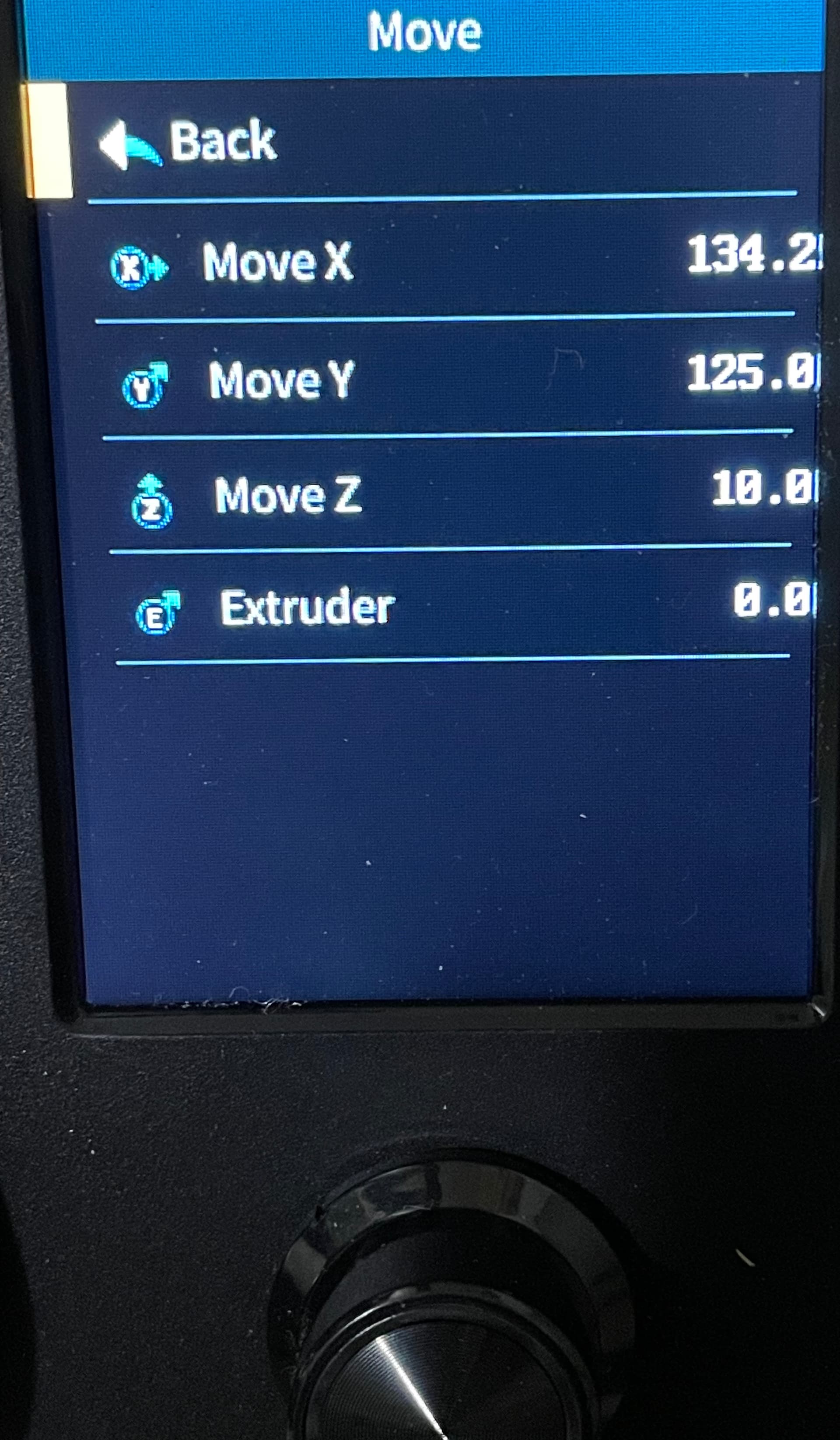

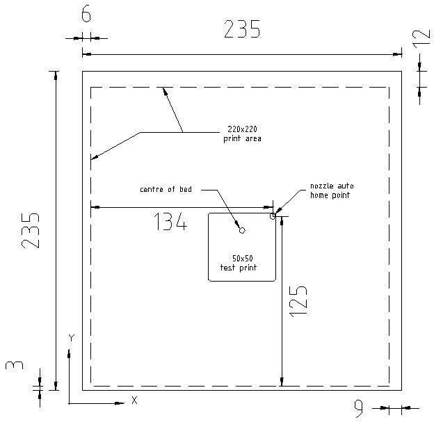

Is there a means of relocating(offset) the print head’s Y and X axis homing point, via the LCD control pad? I was unable to readily see any ability within the menu pad, so is distance hard coded within the printer’s operating system, relative to the limit switches?
I would like to move Y axis home point in a + direction by maybe 5 mm. As you can see by the attached pics, the 220 x 220 print area skirts the front edge of the bed with only 3 mm to spare.
I’ve carried out several small printed objects without issues, quality is great. They print centred in the X axis; however, the prints are off centre in the Y axis by approximately 15 mm towards the front of the bed. I am aware that I can correct this if I choose via the slicer.
So can the user offset the existing X and Y
