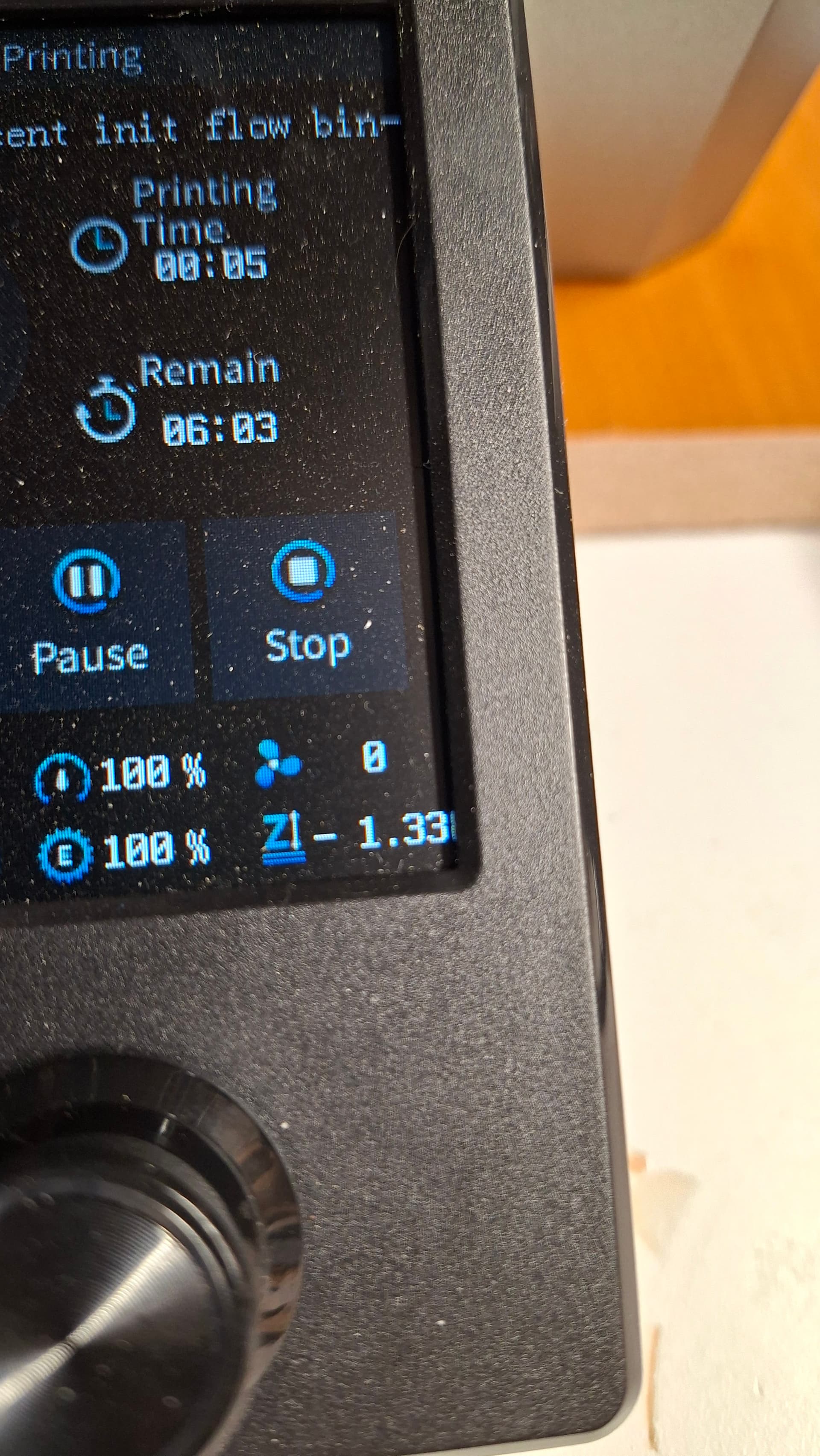

Due to adhesion issues I was forced to dive into the Z axis offset. Now I have a question on how my Ender 3 v3 SE behaves.
With the 16 points automatically accounted for, does the print head keep these in mind at each point relative to the mesh?
I ask this because the print screen has a Z axis value that’s far into the negative and most of my 16 points are 0.00 or positive.
Hello !
I think you’re confusing the Bed leveling (that shows how leveled is your bed. So it tells the printer to take it into consideration)
And the Z-offset (that tells how close the nozzle is far from for your bed when you’re printing something)
On the V3 SE, a Z-offset of -1.33 is kinda correct. It’s generally between -1 and -2.
