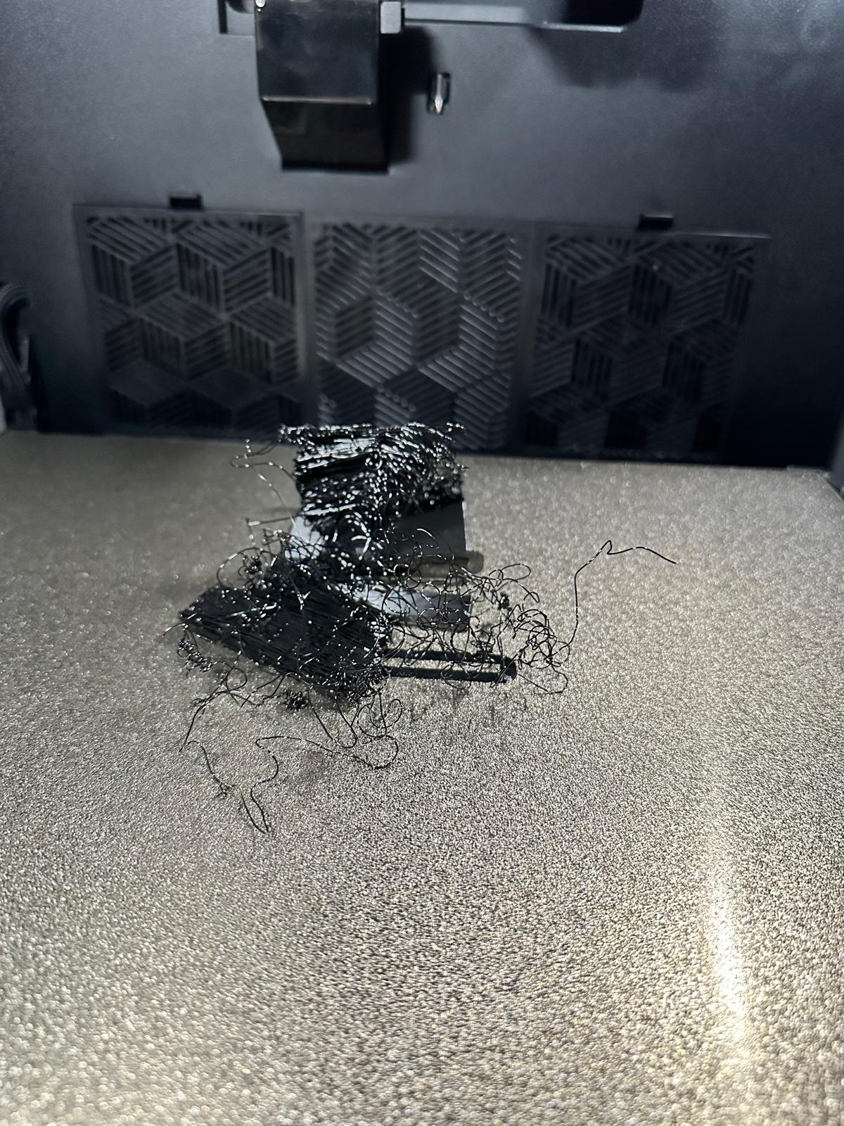

Whatever it’s doing that the zipping noise is occuring, is now more frequent and in a different area and motion. Something is definitely bad here with a gear somewhere. Quite frustrating. It just caused some feed issues that affected extrusion.
A result of a simple print of 2 small plastic sheets since this grinding noise is getting worse:
