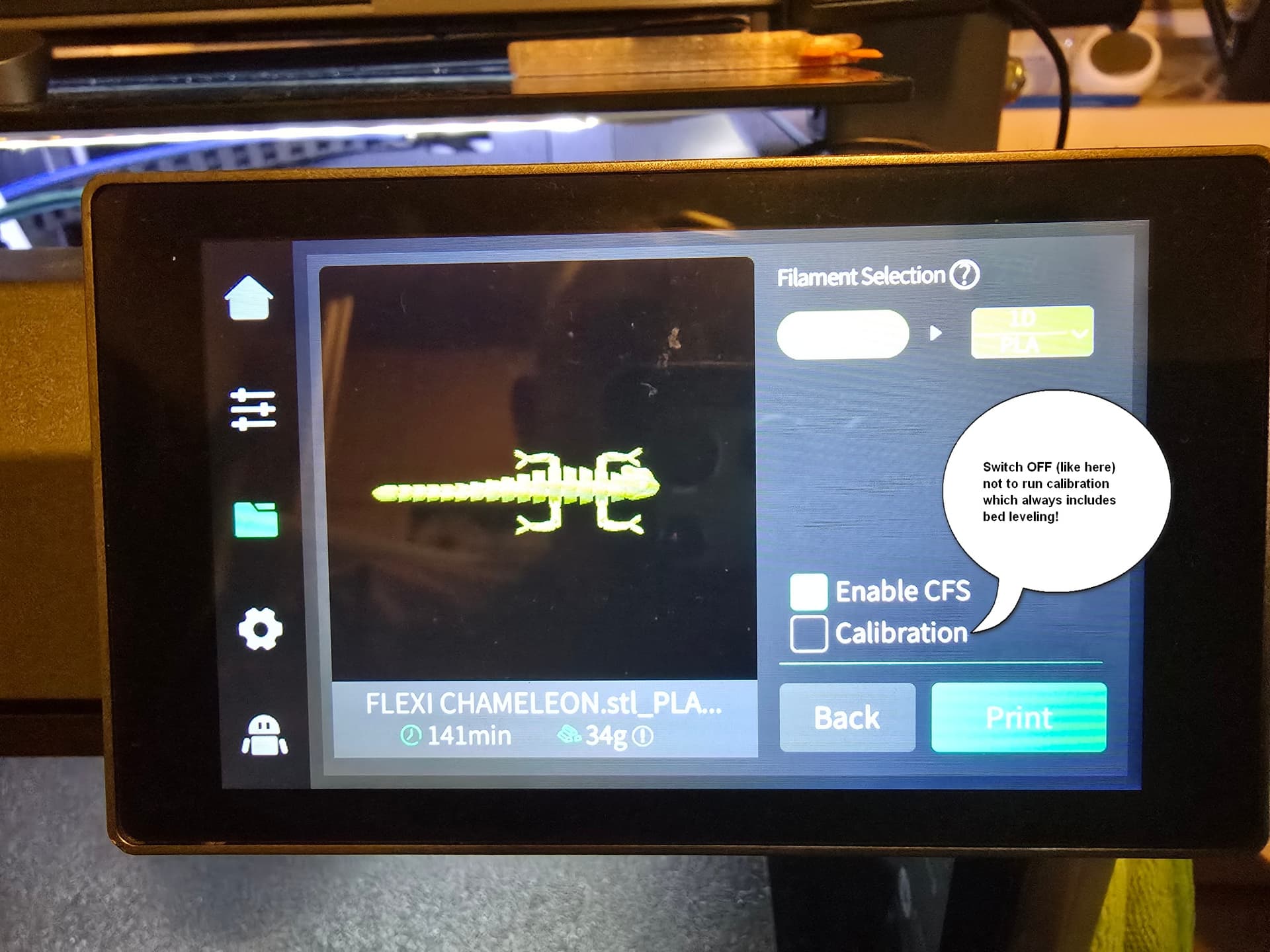

Mine seems to be running a bed leveling before every print, is there a way to disable that? I’m on fw 1.1.26. Thanks.
I have V 1.1.2.10 but already since all 1.1.1.? the printer performs a bed mesh on every first print after switching it on, regardless if calibration is set in printing.
There is another setting on the printer which defines if the printer will also run PA and Flow rate calibration.
I have this switched on all time because I use the calibration flag on sending or printing from printer only when I create a filament profile for a new filament type. and without that it’s not performed.
Then, it depends how you print, either from printer or from CP6 slicer, whenever you switch calibration on it will run bed mesh calibration and then, depending of the above settings also PA & FR:
From CP6 printer:
From slicer:

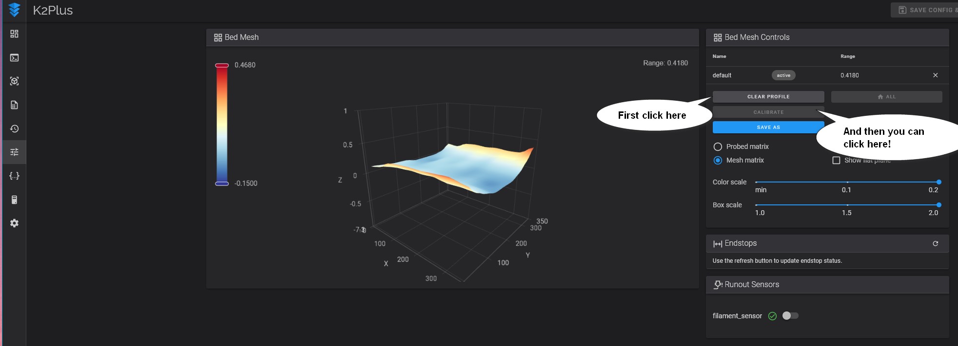

As I print 99% from slicer I set it only for a new filament test. If I change or remove/clean build plate over the day I run bed mesh via fluidd:
But if I print normally over the day, even different filament types, and do not need to remove/change build plate (I have 3 different) I do not run bed mesh over hole day. I only clean gently build plate with IPA every view prints.
Thank you for the detailed explaination, but I already have my settings just like you. The problem is, no matter what I select when printing, either by uploading then select print from the touchscreen, or directly from CP 6, my printer always performs a bed mesh, not just the first print after turning it on.

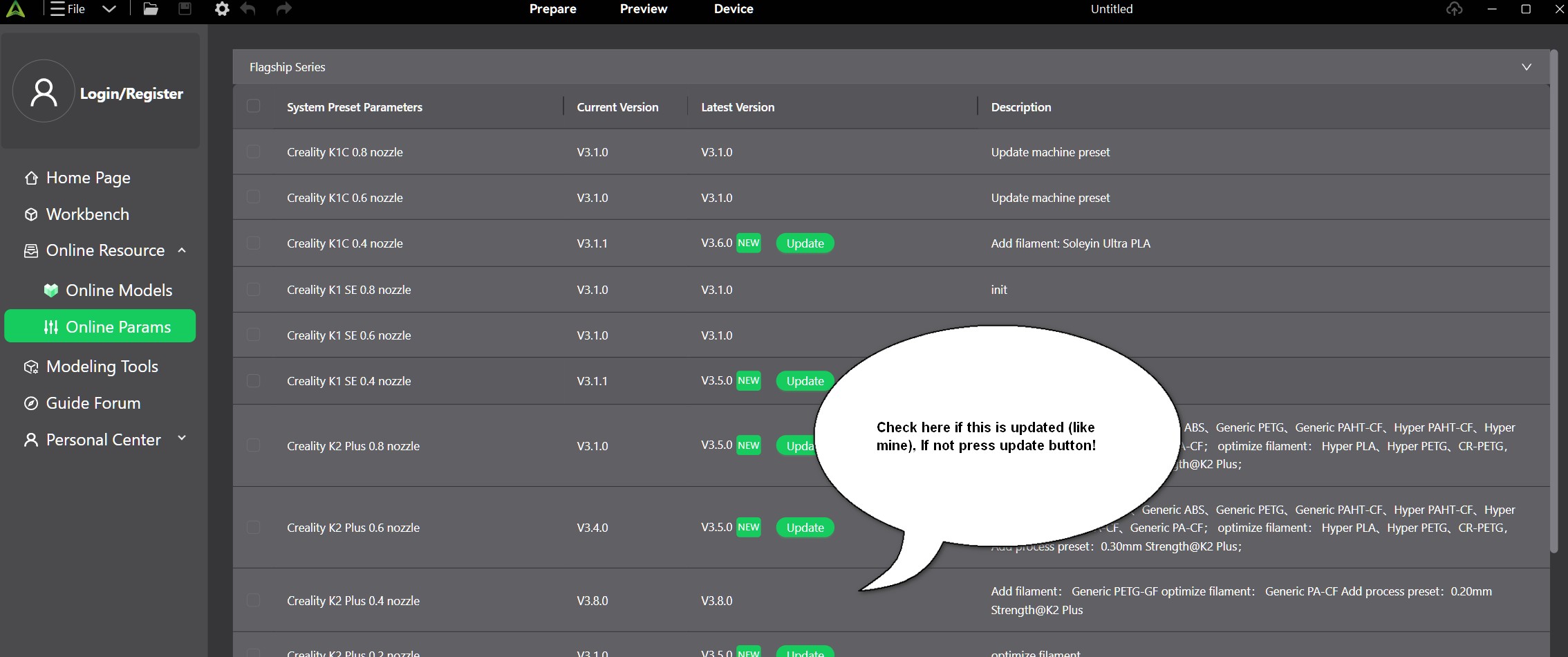

Ok, only thing which could happen is that you use old/bad printer config. Do you update them as well?
In CP6 here:
Otherwise if you use updated FW and CP6 it is defenitely not possible to have permanen bedmesh if calibration flags are cleared out when printing (2nd+ time).
Yes, they’re all up to date. I’ve seen other people saying they have the exact same issue as I am, the bed leveling happens every single time
What fixed it for me is I had to manually downgrade from 1.1.2.10 to 1.1.1.7, then update the firmware one at a time. I just received the machine like 4 days ago, and after setup it updated from whatever it came with to the latest, looks like there might be something that went missing during that jump. So now it’s finally skipping the bed leveling on subsequent prints. I’ll power cycle it after finishing this print and make sure it stays like this.
