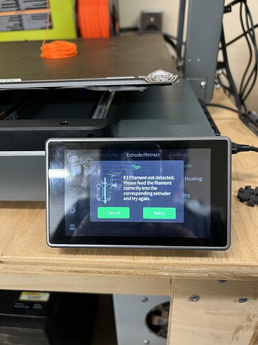

Well I finally got it to work partially. I had to install mainsail and use it to set up the serial path for kcm and chromahead. Units bought directly from coprint must be different because the kit is meant to work on any kipper machine. Now I have another problem when I extrude it squirts filament for a long period of time then shows an error saying filament not detected
check the filament sensor ?

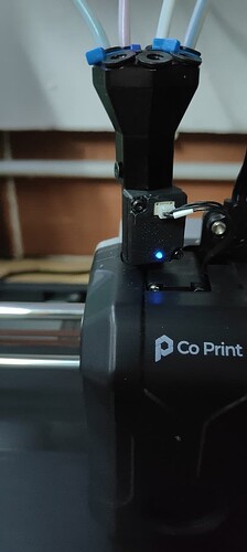

I also bought it from Coprin, and I didn’t do anything, I just installed the firmware and the Orca slicer. Fluid is available from the Orca slicer, which is the same as Mainsail, only called Fluid. However, I didn’t have to set anything here either. And I only use it because I can see what the printer is doing through the camera. I assembled it and it worked immediately. It will only work with the Orca slicer, other slicers don’t have the Coprint profile. It can’t print models that come with the printer, such as the Nebula console, it says the same thing. If you send it to the printer from Orca, it works. This may be because the Chromahead retracts the filament after each print, and you have to start by threading the filament, but the factory Creality models don’t have this function. However, if it doesn’t work even when sent from Orca, then first check the filament sensor. If there is filament in it, a small LED will light up blue. If there is a filament in it and it doesn’t light up, then either the sensor is not connected or it is bad. It could also be that the feeding extruder is not able to push the filament. There is a spring screw on the feeding extruder, it is worth winding it about halfway to make it clamp the filament with more force and prevent it from slipping. In addition to the previous slow boot process, if you use a USB hub, it can cause communication problems. For example, I tried 2 types, with one the camera works sometimes, sometimes not, with the other it doesn’t work at all. Now I’m going to try a third one, which has its own power supply.
Mine didn’t come with a filament sensor. Fluid doesn’t have the device option that mainsail has to get serial path. Should I have the sensor? Not all that I have seen have that under the splitter.

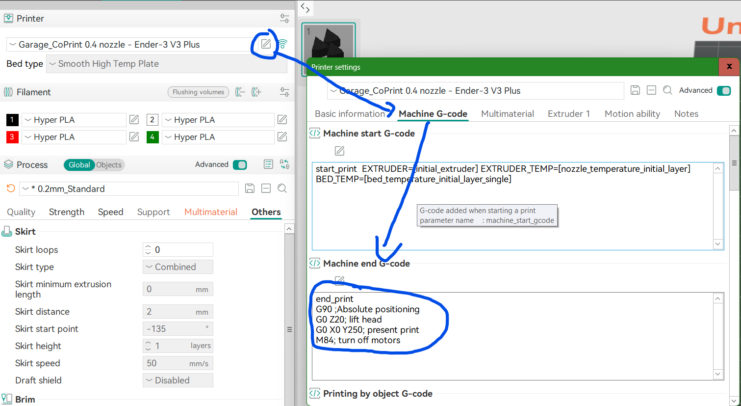

Other. I would be interested in how to print after printing and how to arrange the initial home position to the left, and much higher? I’m not very experienced in CFG editing. I haven’t dealt with such things before. I would only be interested in this because it’s inconvenient to remove the printer plate, because the print head stays very low.
you can add end print gcode in your slicer, here’s mine
end_print
G91 ; Set all axes to relative
G0 Z20; lift head 20mm
G90 ;Absolute positioning
G0 X0 Y250; present print, move bed forward to 25cm
M84; turn off motors
Note;
I place the M84 to be able to slide the hotbed freely, but it also releases the Z motor and since the chromahead is very heavy it may go down… so use carefully
(ignore the gcode in the screenshot it’s bad, the G0 Z20 moves head to 20mm above bed which will collide with print, my gcode above is fixed)

This end g-code works, tested myself last night
end_print
