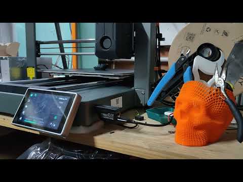

Filament change video;
Note, I inserted the new filament before pressing retry.
It worked as expected
I made a video too. I used it with two colors. It did the same thing as you. However, if I use only one color, then on top of that, when it goes back to print, it goes towards the print and extrudes a huge blob onto the print, then continues printing as if nothing had happened. But this small mistake is also annoying, because as you can see, it got stuck in my head. A short while later, after I stopped the video, it tore up the part that had been printed so far. https://www.youtube.com/watch?v=J8urTub8q4E
