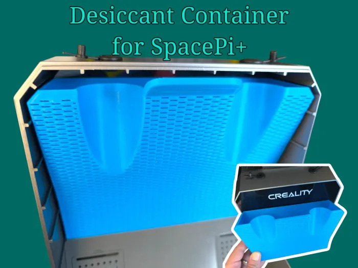

While digging around online about the Dual, I saw a lot of people saying they couldn’t drop the humidity below 35%. To fix it, they put silica gel beads inside the machine, usually with a little printed container near the filament outlets. I printed the container earlier this week and ordered silica beads today. For now, I tossed a few 5 g silica packs inside the machine. That way they can soak up extra moisture and keep things dry. It’s actually working great — humidity is sitting around 24% now and the prints are super clean.

  • Can the printed container cause any problems for the machine? Anyone tried this before?

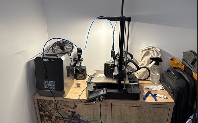

  • My setup area doesn’t have the best air circulation. Temps can hit 28–29°C. I added a medium fan to the back top of the unit and managed to drop it by about 2°C. On my single-filament Space Pi, I think overheating is what caused my issue. To avoid the same problem with the dual, I’m thinking about adding a bottom cooling fan compartment. Worth it or not?
  • Biggest question: how long can I safely keep this thing running? Like after 48 hours straight, should I power it down and let it cool, or is it fine to just dry the filament and then shut it off? Any “best practices” here?

On the no exhaust.. my space pi dual has 2 small holes in the flip lid which are the exhausts..
Which i plug via printed inserts if im leaving spools in it long term between use/drying.
The issues with long term use only seem to arise if the lid is not fully shut, I.e too much heat escaping, causing constant heating as opposed to heat/hold.
