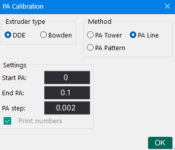

Before you can use pressure advance you need to set things up and calibrate for it.
In OrcaSlicer (what I use), you can find the option for your filament here:
Than run a least this calibration test:
See Calibration · SoftFever/OrcaSlicer Wiki · GitHub for more info
