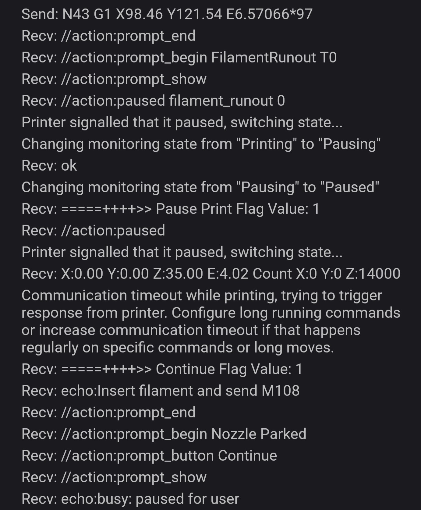

However, I am not sure if this is firmware related, but I tested if a print pauses due to filament runout sensor flagged the print to pause, changing/adding the filament and resume printing via OctoPrint/OctoApp, will not resume the print, especially via the host (printer’s LCD knob). Cancelling will just hand and heater will timeout, reheat and timeout again until printer is reset (and print is ruined hahaha). Upon checking the terminal, it seems that the filament run-out sensor does not send a M600 command as follows:
Let me know what do you think of this. Happy holidays! :christmas_tree:

So if I understood correctly the resume/continue button from Octoprint didn’t worked right after sensor paused the print? Knob from LCD will not work since Octoprint is already connected.
I don’t have a filament runout sensor to check; but I will try to check from code the flow to see if can be fixed.

Can you share the complete output of terminal log and octoprint log?
Looking at the code the runout sensor uses M600 command, so teorically it should work with the previous fix, but in your log Im missing some parts of the flow. I’ll need to check it to see where it breaks, since I dont see the resume flag.
Hi @darkclover92 I built a DIY runout sensor to test the firmware and it worked as expected. You can take a look:
In the bottom left when the led become red it simulate the runout of the filament and in the upper video of Octoprint page you can see the activity. I tested with Octoprint and with the printer knob, both worked as expected.
Buuut I’m not sure if the original sensor send the same voltage signal, I’m sending high 5V when it simulate the runout.
Maybe I can send you this version of the firmware that has debug information for the serial terminal and you can send me the log while using the real sensor?
I have the official Creality runout sensor on my SE and things work just like in your video on my printer.

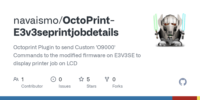

Hey guys - New here and new to 3d printing! Thanks for this entire effort and soooo glad I found this thread.
i just installed the 1.0.9.7_4.b custom framework to my brand new SE. My device was (confusingly) running 1.0.7 already…
Anyway, maybe I misunderstood but I thought that one of the updates would be such that if a print is started via Octoprint, it would still show the “origin” progress information on the LCD screen still.
i plan to run from Octoprint, but would be nice if someone went to directly inspect the printer they could still see the original LCD output.
Hi, nope this firmware that I’m working with was edited with the goal of showing:
  • Time of the print. Calculated by Octoprint, or Print Time Genius or from M73 command. :white_check_mark:
  • Print Time left. Same as above. :white_check_mark:
  • Layer progress. :white_check_mark:
  • Percentage of progress. Based on Time elapsed, or Layer or M73 command.
  • The thumbnail of the GCODE. Since no documentation found I’m trying to brute force the access to the memory of LCD so for now we just see the Standard Creality superMan :x:
  • Fully integrated with Octoprint rather than standalone. This because I use heavily Octoprint. I would say the integration is working fine with the help of the plugin. Without the Octoprint plugin installed you will not see the updates in the LCD.
So the disposition of the LCD GUI went a little bit different but trying to keep the same layout and look and feel. The LCD is super tiny so can’t add much on it.
