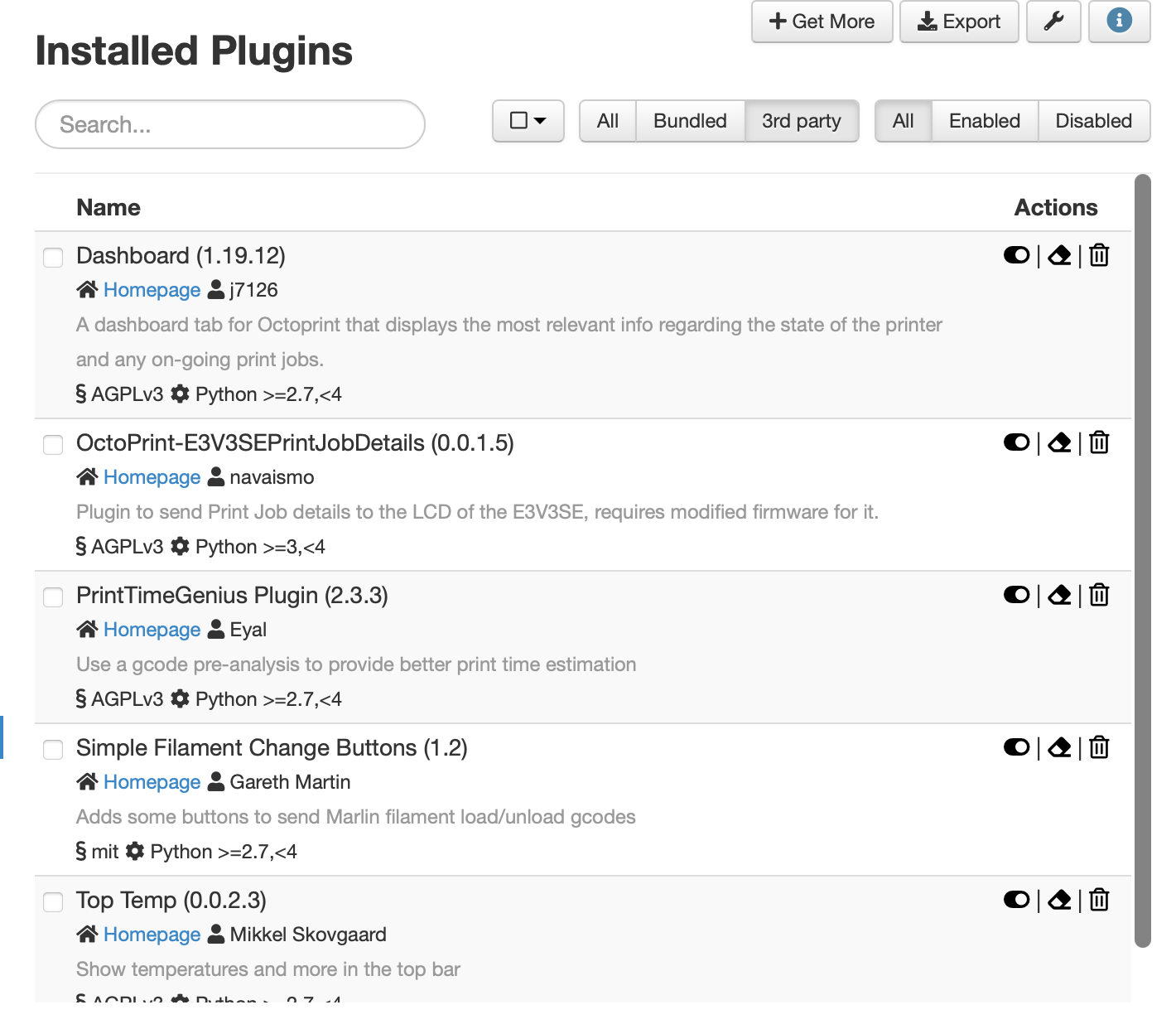

Did you installed the Octoprint Plugin too?
Check the readme in the GitHub to get access to the Octoprint plugin that enables the communication between Octoprint and the printer to render in the LCD.
Yea, I thought I did… but maybe I didn’t do that right? Here is what I see in the plugin manager in Octoprint:

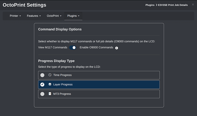

And what about the configuration of the plugin?
Are O9000 commands enabled?
And Progress configured too?

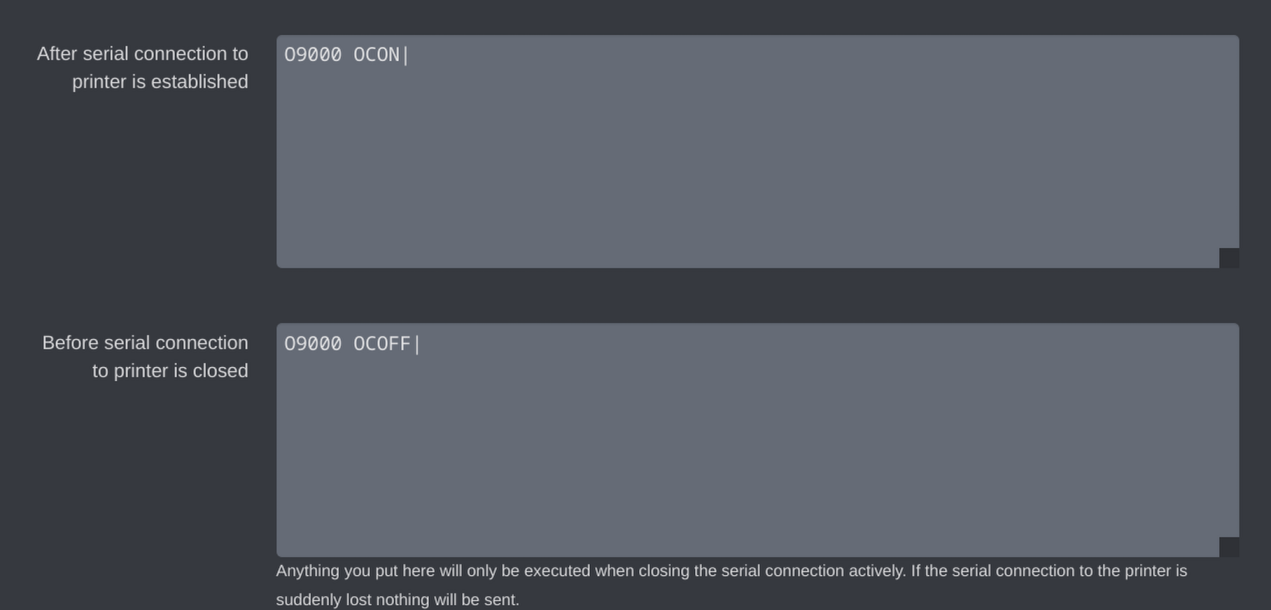

ohhhh shoot. I do think I forgot those parts. Let me try that. to be clear, its just the two screenshots of the 09000 OCON| and the other?
Yes, you need to enable the O9000 Command:

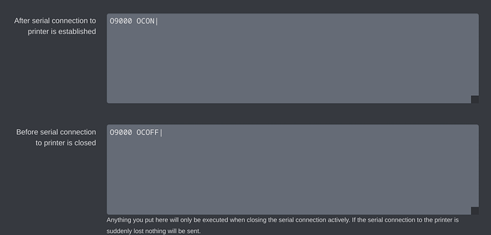

And with the latest firmware update, you need to add the serial commands too:
The Gcode scripts are recommended too, or at least send the M117 after cancelling to clear screens. I’ll work later to have a cancel screen with an O9000 cmd.
Fantastic! This was completely what I had missed. I am all set now, thank you and sorry for the dumb missing of steps.
