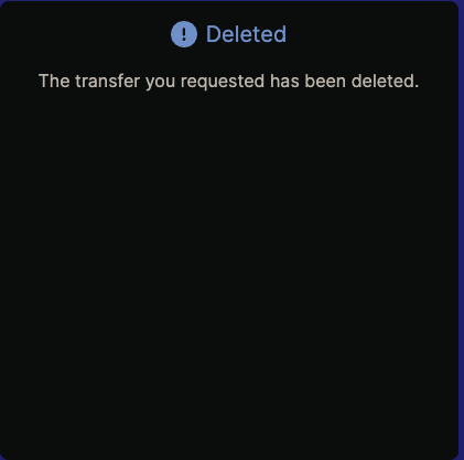

Also, it looks like your configs might have gotten deleted =/
Also, I forgot to mention, its the official creality filament runout sensor like the one that comes with the KE. I just bought it from Amazon and added it through the available pin on the board. I’m sure youre aware, but they seem to come with prebuilt ports for the light bar, runout sensor, and Sonic Pad already on the printer’s board so you can just buy them and plug and play. I went that direction for the runout sesnor right after I bought the printer. But I decided to DIY my light bar so I could run it through a Tuya device and connect that device to my Alexa. I’m a big Star Trek nerd, so Alexa is renamed “Computer” around my place. And all the rooms are “Captain’s Quaters/Engineering/Shuttle Bay” rather than bedroom/laundry-print cave/garage." Lmao. So between that, an Octoprint plugin or two, and Alexa I can say “Computer, tea, Earl Grey, Hot” and it’ll turn the printer and lights on. Then “Computer, report” give me the name of the current print and the remaining time, etc. I really go out of my way to make a fool of myself. Lol.
Ok try this link for the orca files.
