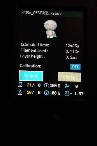

Not sure if this is a known issue or there is a way around this but for your information, I noticed when I went to do another print the same as the one I just completed that an error come up sending the info for rendering to the screen.
The print did start but no rendering of the lcd screen was available.
Not sure how it all works but to me it appears like memory may still contain the rendering from the first time it is printed therefore preventing it being reloaded back up ???
If you turn printer off, back on, and start print job the file is rendered and sent to the screen no problem.
Sounds like there is no data passed from Octoprint Job’s to the plugin.
You can share the Octoprint.log and the EV3SE.log to see exactly whats going on.

Yes, as suspected no info from the JOB is sent to the plugin.
+2025-02-25 23:06:30,486 INFO: Direct Print? Metadata not sent yet
+2025-02-25 23:06:30,492 INFO: >>>>>> Called get_print Metadata for None
-2025-02-25 23:06:30,497 ERROR: load_metadata_from_json: Failed to load metadata from /home/huggy/.octoprint/data/E3V3SEPrintJobDetails/metadata/None.json: [Errno 2] No such file or directory: '/home/huggy/.octoprint/data/E3V3SEPrintJobDetails/metadata/None.json'
-2025-02-25 23:06:30,542 ERROR: get_print_metadata: Error retrieving metadata for None

I printed the item where the info displayed ok, then a few minutes after it finished, I printed it again because i was not happy with the colours, when i went to click the print button on Octo is when the error occurred. I rebooted printer and all was right again.

I hope this helps, not only does it do it if you want to print the item again but also I tried a quick print, let it run for a couple of minutes, cancelled the print, then restarted the print and the same occurred.
So basically on a loaded file octoprint isn’t sending the info again.

As another test to help rule out some stuff, i started the level test print (small print) cancelled it after a couple of minutes, then restarted a completely different print and that worked perfectly that it rendered it to the screen.
So it only appears to be if you want to reprint the same print again when the issue occurs, or if you cancel that print and restart the print.
Should be fixed in the Release v0.2.3

I can confirm upon cancelling a print and restarting the print that it now works.

I was about to create an issue on @Iroh3d repo for his latest and best firmware yet! I had the same issue when reprinting the same file (print repeat) where the OctoPrint has already selected the file prior to the first print and when I press the print, the thumbnail will fail to render to LCD and no updates on the LCD, not even the print progress. However, I notice the LCD actually updates something but not correctly.
The only way around it was to either initiate the same print via OctoApp (yeah, it actually works but it pauses the print temporarily and after thumbnail is rendered to LCD, it resumes, no issues there) or if on OctoPrint, select a different file, let it render the thumbnail for that different file to LCD or cancel it ‘X’, then reselect the print file to reprint and it uploads the thumbnail again.
