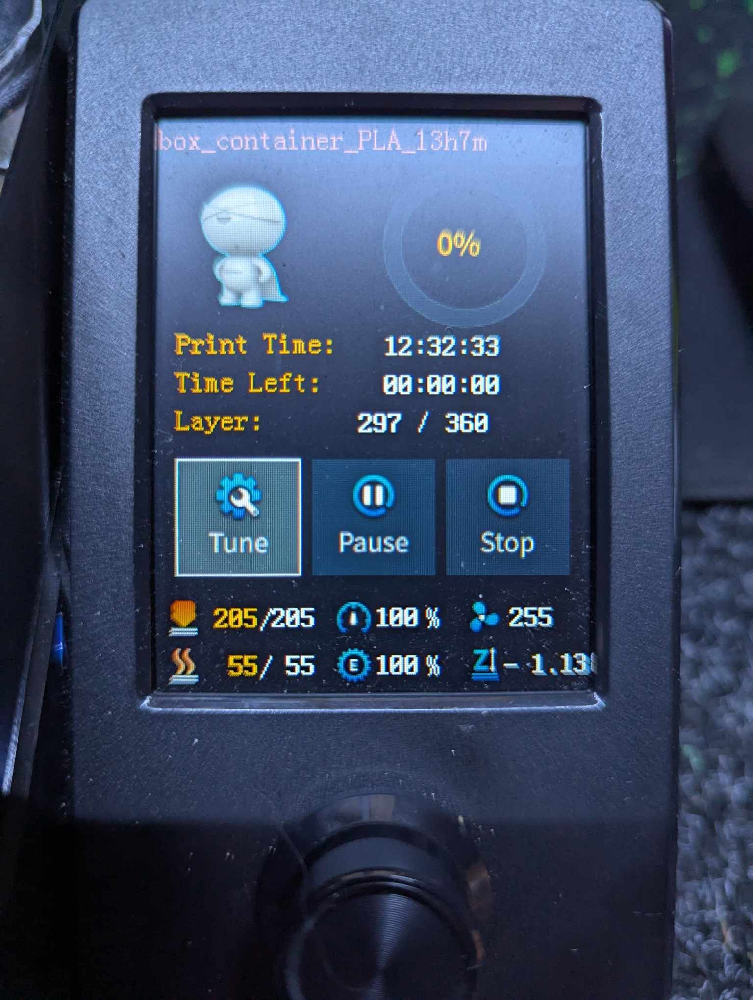

I did make mention of this further up. On a couple of occasions in the last few days, Im noticing on longer prints that the info does not update. The layer number increases but the percentage or time remaining reset themselves. When starting the print and for some hours it all updates correctly. See picture below. Its not a big issue but just raise it in case you may find why it does this.
Hi, yesterday finished a +18hrs print without issue so to find the problem do you mind to share the E3V3SE…log and the octoprint.log with the aproximated hour to see why it reset the values?

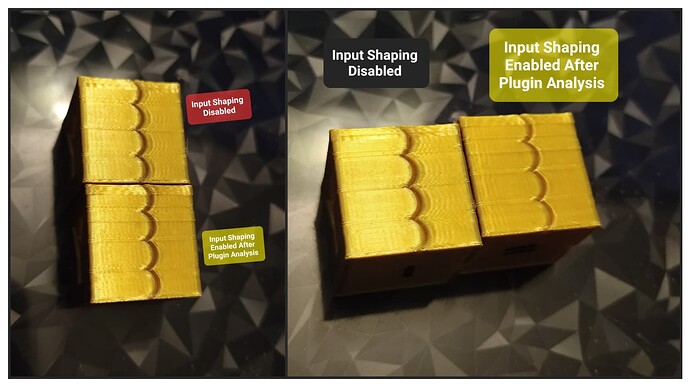

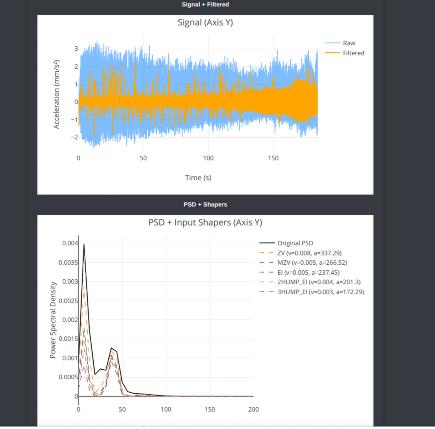

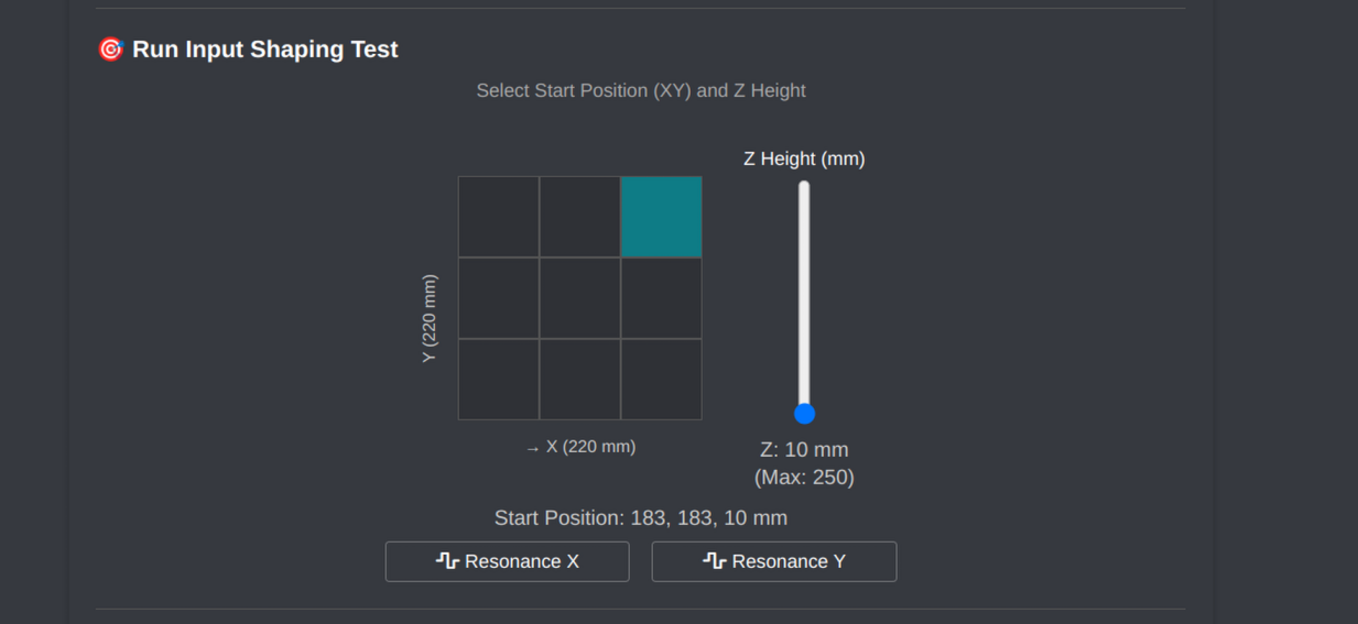

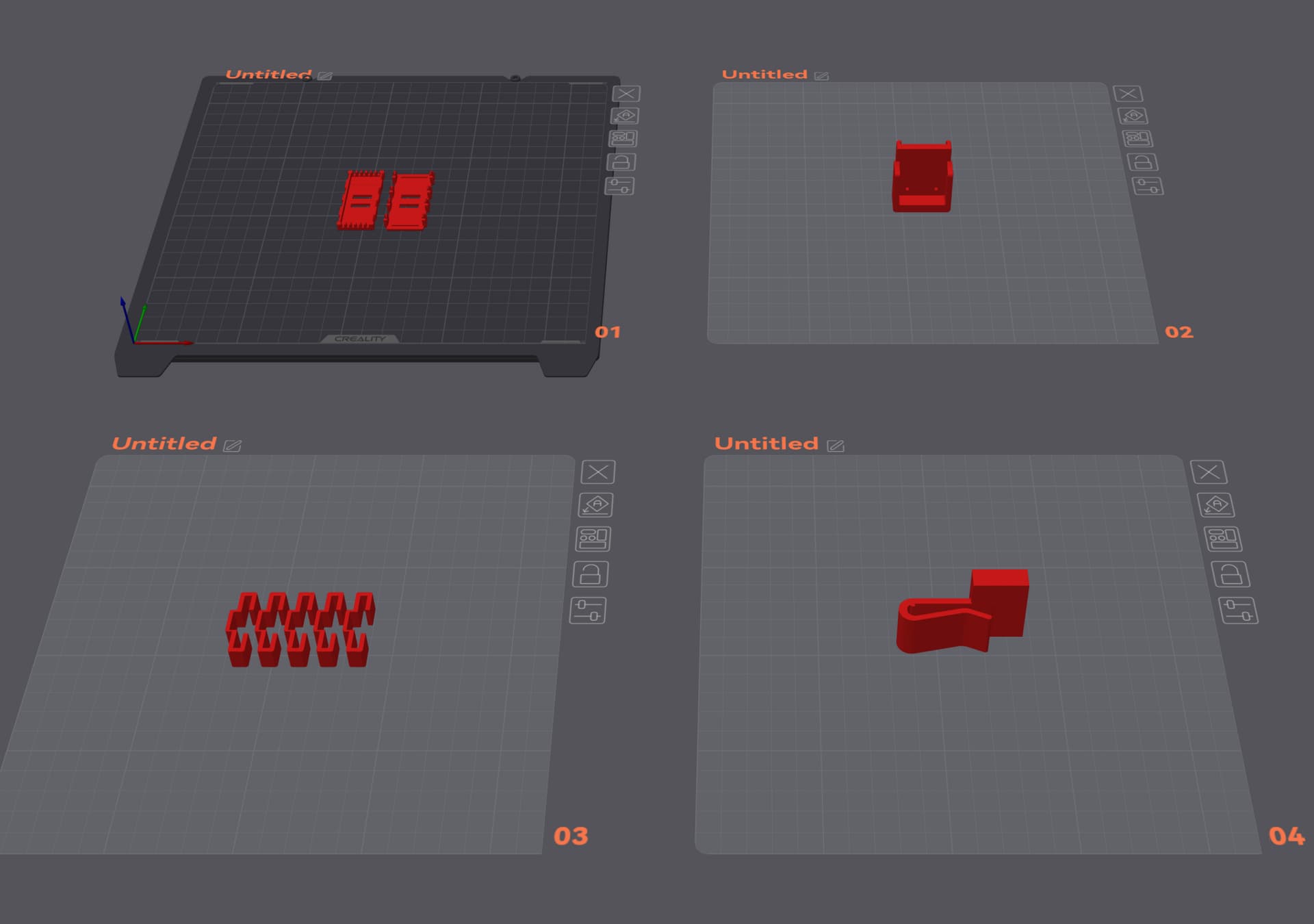

Hi everyone!

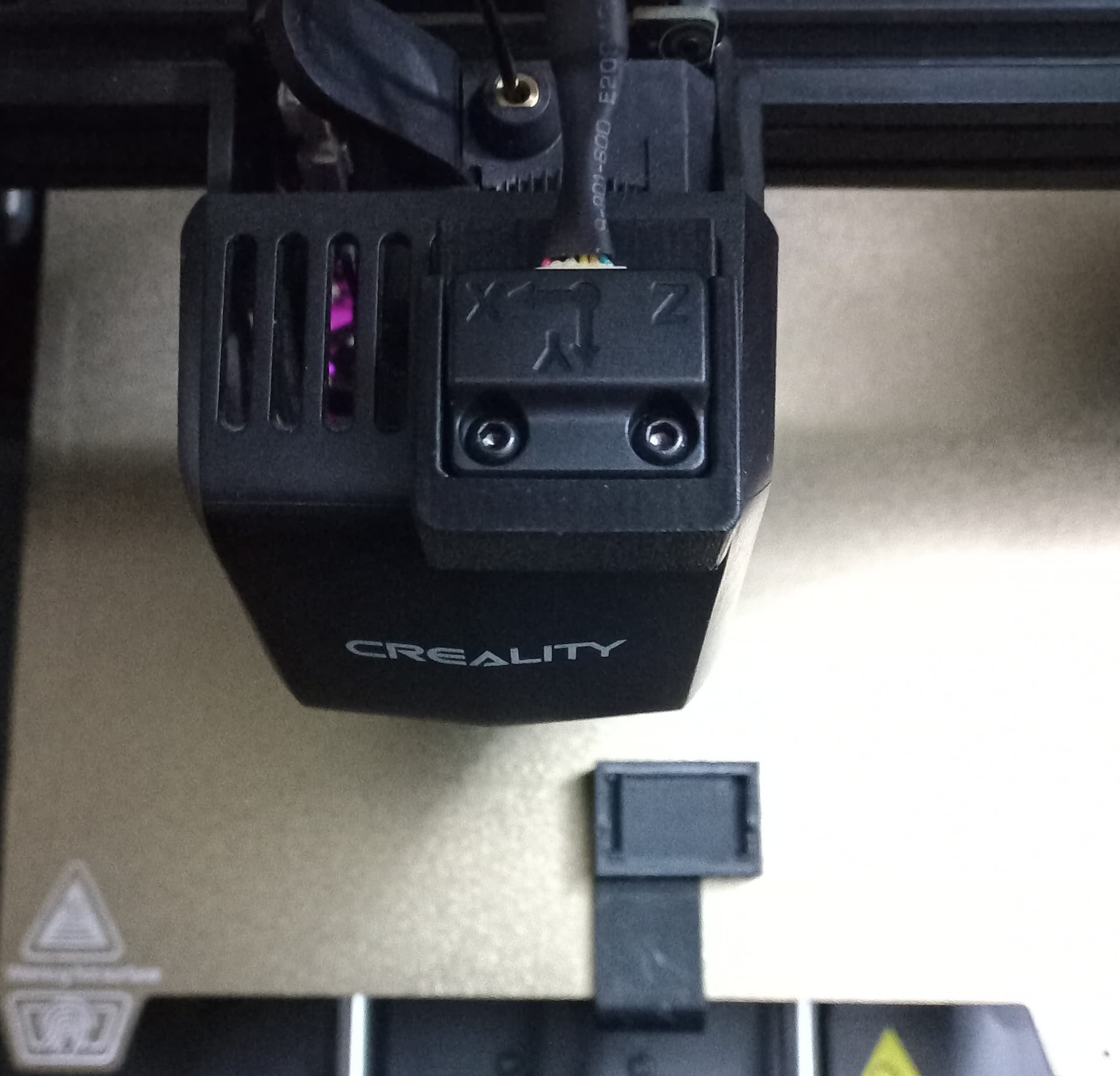

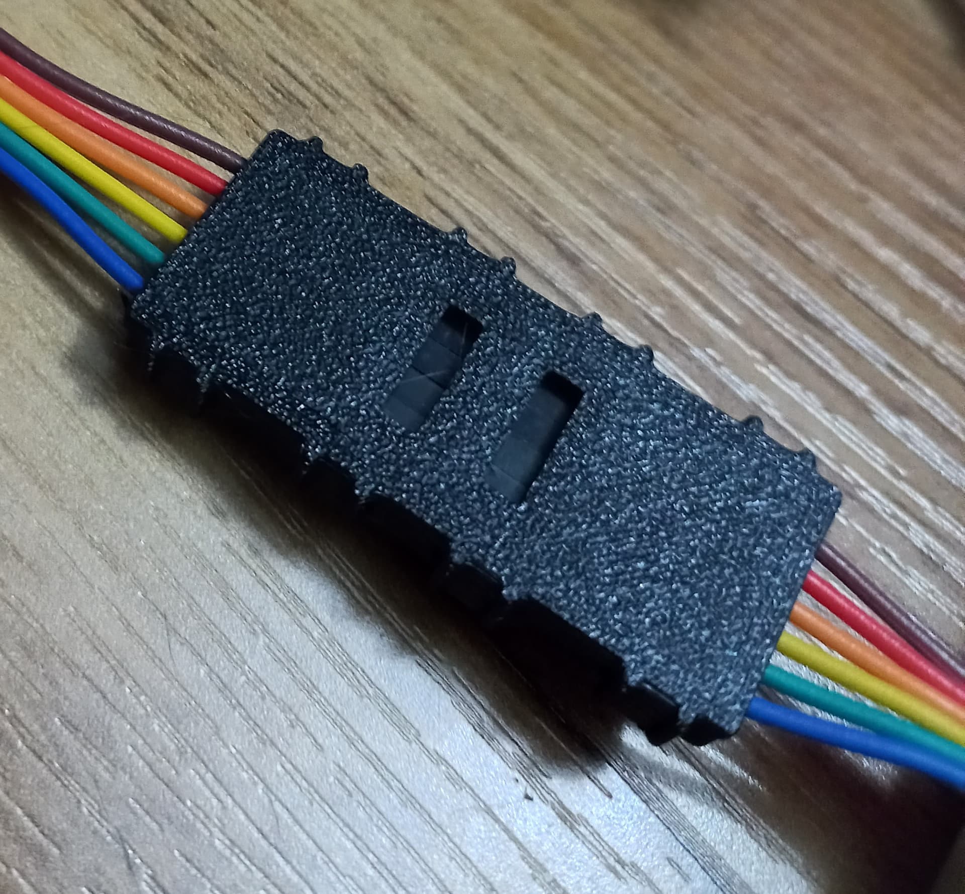

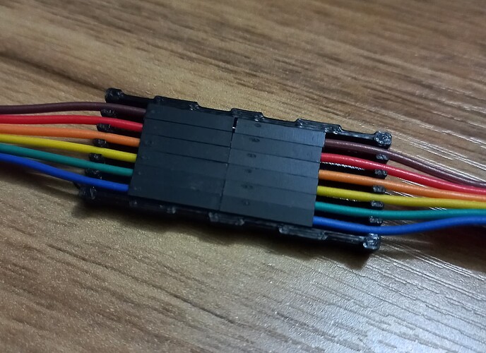

I just released a candidate for the Input Shaping plugin for Octoprint and Marlin if you have a Raspberry Pi 3B or superior and are willing to test and provide feedback on the github repo please let me know:
Refer to the github readme to set it up.

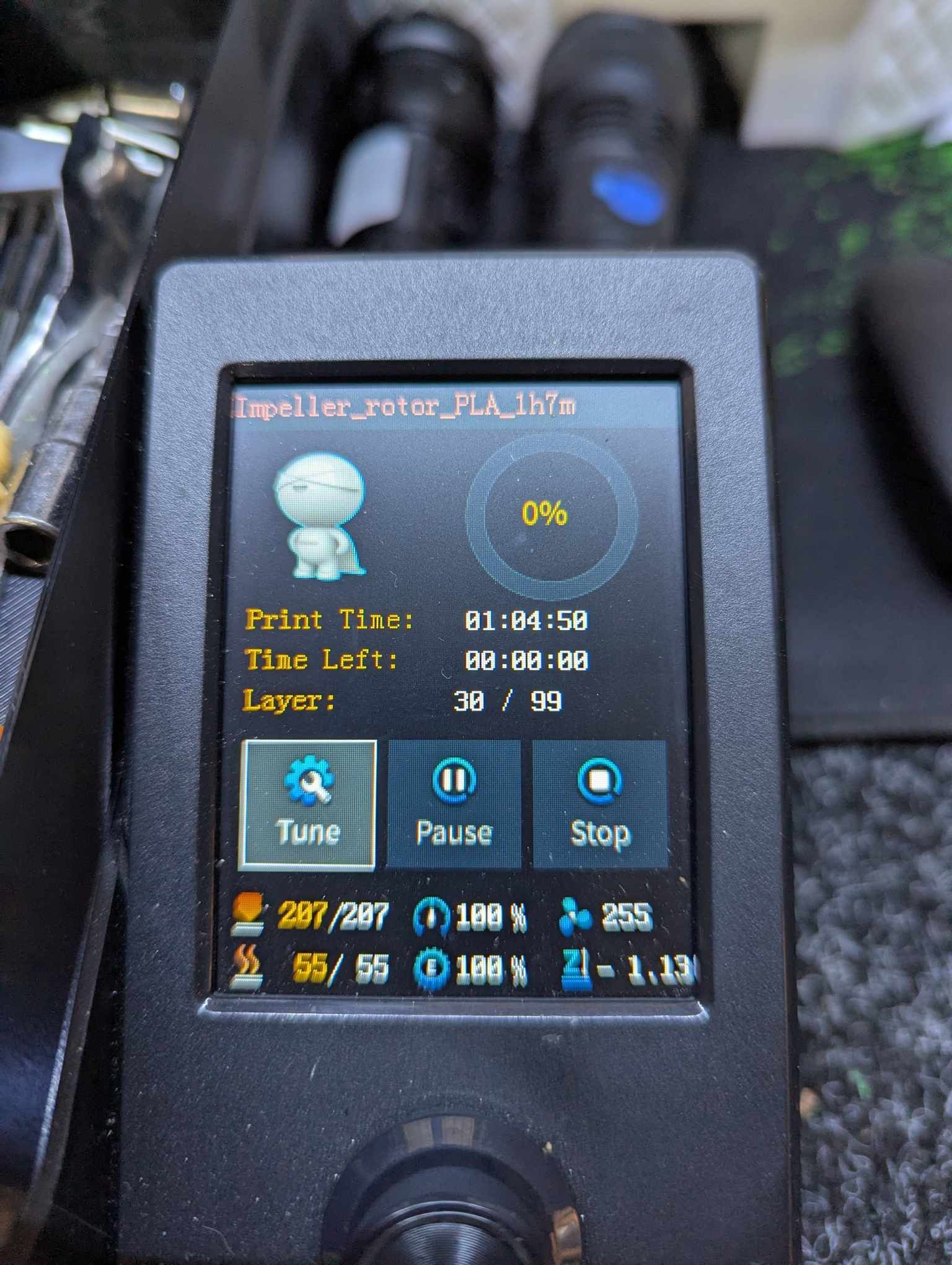

Hi @Iroh3d
I think I have worked out what causes the problem with the display not updating as per above pic.
What I have discovered is when the printer is printing a file, and if I upload more files to the PI for printing later is when the the current print will drop the percentage and time remaining on the printer display after a few minutes.
I will get a log organised for you as per your request in the next few days.
Hi @Iroh3d
I was easily able to replicate the issue with the print time remaining and the percentage restting to 0 then sitting at 0 until print was finished.
I started the print and when percentage was at 9% and time remaining had gone down 10 minutes from total print time and at 7 minutes into the print I uploaded another file to be printed later to the Raspberry PI. Once I had uploaded that file the file that was currently printing reset its percentage and time remaining to 0
I have the log files and the time that it all happened was at approx 9.40pm for file upload and within a minute or at around 9.41pm the screen display had gone to zero.
Both log files are in this zip file, however, I had to put .pdf at the end of the zip file so that I could upload it to here.
Just remove the .pdf extension.
octoprint-logs.zip.pdf (3.4 MB)
