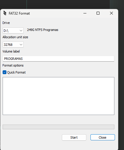

So I’m having the same issue, putting the card in the printer and it shows nothing I have saved. When I put the card in my pc it now says windows doesn’t recognize it and I can’t even reformat it
I had this issue too, I formatted the card on my computer and tried again and then it worked. Looks like its an SD card issue
LO LOGRE, utilicen este y conviertan la memoria a fat 32 y si la tienen de igual haganlo esa es la solucion el de windows no se que tiene pero con esto me funciono
