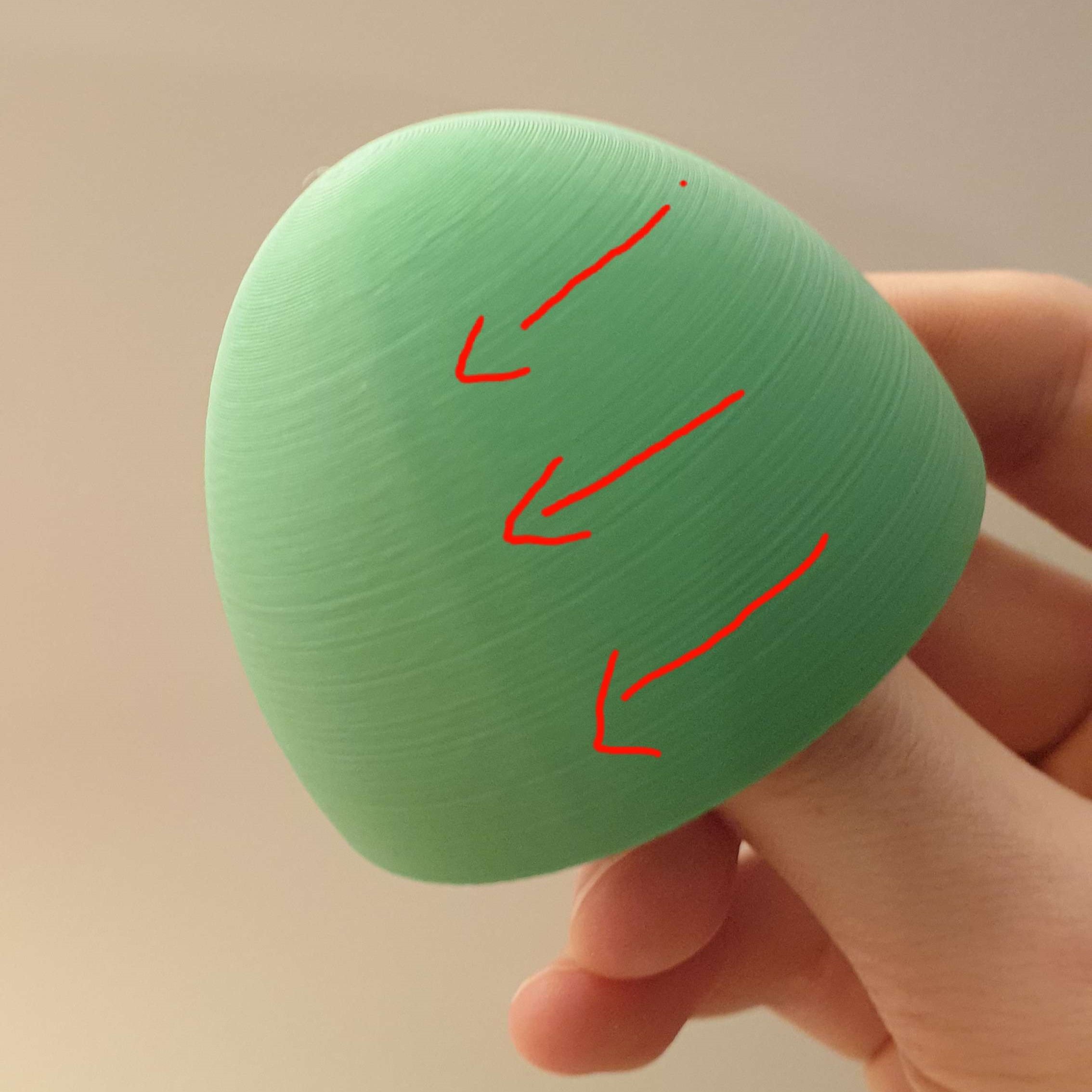

I have a problem with my Ender 3 V3 KE, and despite numerous calibrations, it persists. When I print cylindrical shapes (see photo), I see a bump that extends along the entire Y axis.
What I’ve already tried:
- Update the Y axis with linear rails.
- Checking the belt tension.
- VFA (Vibration Frequency Analysis) tests
- Reduction of speeds to limit inertia effects
- Calibration of the pressure advance.
- All the other usual calibrations (E-steps, Flow, Acceleration, Jerk, etc.)
Despite all this, the problem persists and I don’t understand where it could be coming from.
Have you experienced this problem before?
