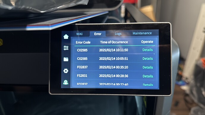

I’ve been battling extruder problems all week. Every time I fix a problem it’s something else. Like okay, fine… but I got the process down to a science and I was really hoping after fixing the ptfe tubing and unclogging and cleaning the nozzle and stream lining the filament and got it all back and printing for like the 15th time that when the job finished I was in the clear. Great print as usual. No cfs problems as the filament retracted properly. But I’ll be damned if I didn’t get an error saying there is a filament read error or something. I knew what it was. I took the assembly apart again and there is filament in the stem. The cutter cut the filament. I’m losing my mind. I know I can unclog it and put it back together again and recalibrate and get another print done but what’s going on here that I’m missing? I’m not putting this thing back together again unless I feel like I’m actually fixing something. Help please?

I was having strange extruder errors and Buffer errors too. Then, while watching the blue LED light on the buffer, I moved the buffer connection cable on the top of the buffer, and the LED would flicker. I snapped apart the buffer, and took out the board. I found the connector had some cold/weak solder joints… reflowed them, and it has not failed since, nor have I had any extruder errors. I think the buffer unit is sending a false error signal that there is a filament jam, and then the extruder stops. Hope it helps a bit.
I’m unsure if this is relevant, but I had similar issues. The last issue indicated that I had a filament loaded from the external holder and would not use the CFS. I disassembled the extruder and removed the screws that held the extruder motor in place. I found that the little ribbon cable to the filament sensor was pinched between the motor mounting and the frame. I rerouted the cable and have not had the problem since. I plan on replacing that cable when support gets back to work!

I just discovered something today. The extruder motor stays on when idle, even overnight. and the extruder gears are hot. Hot enough that I can barely touch it. I’m guessing that the heat from the extruder motor propagate to the filament, causing softening to the filament, and thus jam in the heatbreak. I tried to add M18 E to turn off the extruder motor in the filament end gcode, but that is causing ‘Print Not Finished’ error message, and all motor (XYZE) turned off. Meaning in multi material situation, this is not suitable. The only possible thing is to add the gcode in the Post-Processing scripts, I guess. But I don’t know how to do it.

I’ve experienced this too, with Creality Hyper PETG last week. Had tons of errors and faults related to extrusion and filament. Had to cut the filament bulge out of the extruder. Was racking my brain trying to understand how the filament could bulge there; hot motor makes sense. They’re not reducing current when idle?

Anyway, I tried adding cooling to the extruder, using 20 lpm aquarium aerator pump and silicone tubing. I have not done any extensive print test yet, but on 40 minute print, it seems promising.
If you lift off the hot-end cover, then remove the extruder cover, the pinch rollers are visible. What we mean is the little bit of filament visible above the pinch rollers - it bulges, wider than 1.75mm, such that it then cannot be retracted. Only solution is to remove the rollers and cut out the bulged section.

For example, i think, early or late, all 100% of PTFE spring washers inside the extruder shell will be broken. If your washer is half-broken, PTFE is still on place, but not vertically. And your filament have resistant force, so you have errors.
Only one way for now - change the extruder shell for new, its cheap.

Yep. it happend to me too. Just like printing with soft material. So my current solution is to cool the extruder gear by blowing cold air from outside. So far so good. At leat for me.
