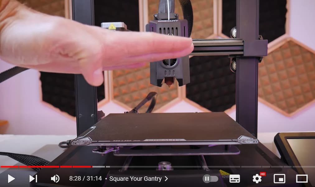

Hey. I faced the same problem and fixed it by following this guide on youtube.
Thats handy, my gantry was about 0.2mm out, not it is parallel, that’s on my V3 SE, I shall do the KE this evening. Cheers ![]()

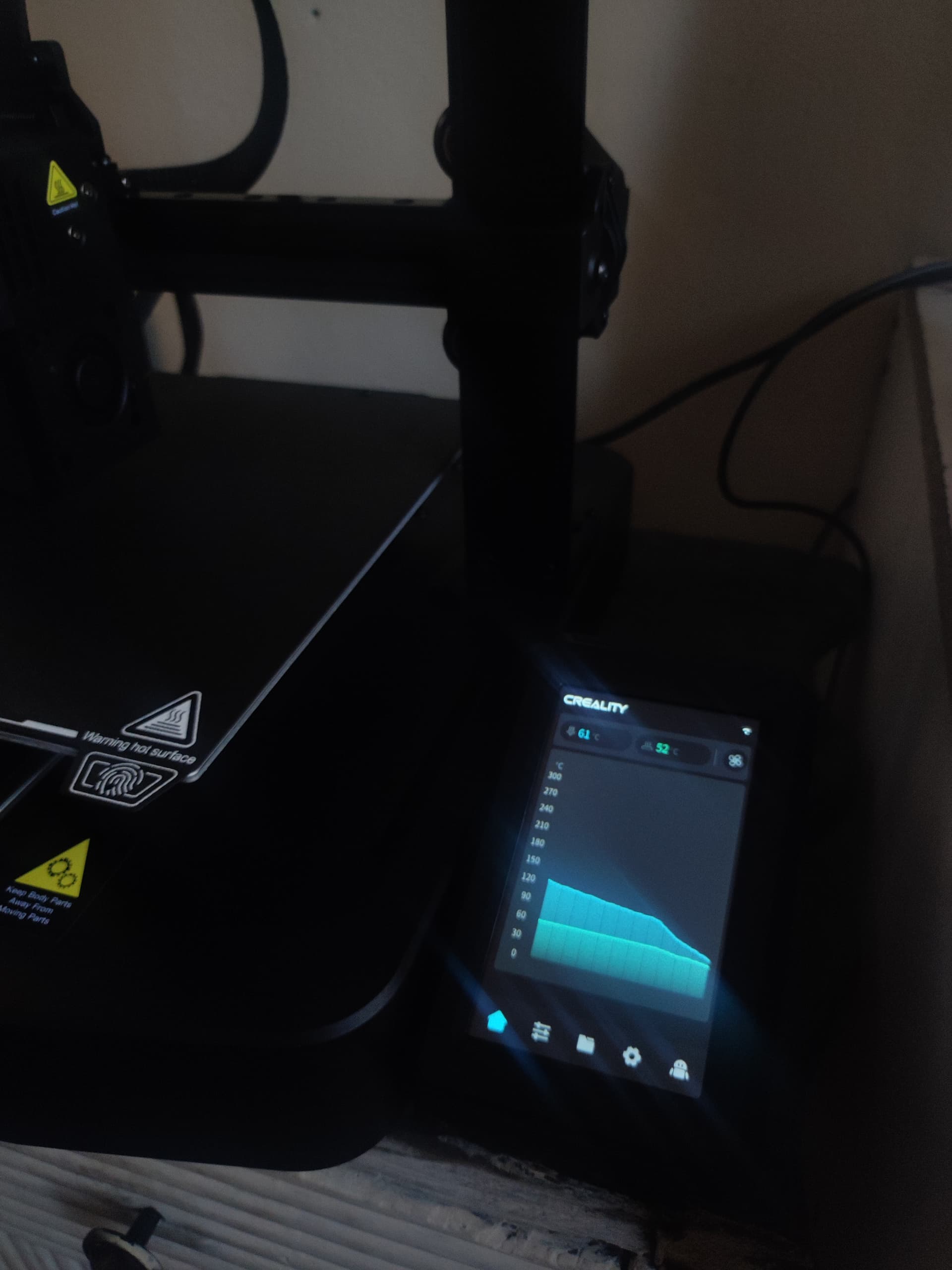

its May 14th 2024, I bought Ender 3 V3 KE exactly 80 days ago and I was having an issue printing 5mm above the air than the bed (Benchy print). So during adjusting the bed i got the nozzle jammed with filament PLA. I tried to clean it by removing the Nozzle but I accidently broke the Hot End. I waited for like another 40 days for the Spare parts to deliver it to me since i had to Order it from third party source from China to Nepal. Later, got the spare parts (HOT END), replaced and installed the hot end with new Harden steel nozzle. and then i was having an error Key:2401 so i tried factory resetting and till this date I am still trying and getting the same error again and again and again. I have contacted the official creality team and waiting for their response. I have checked every loose connection except the Motherboard. I don’t really want to strip open my new printer as it might voilate the warranty or something… so Everyone here, I request a solution of any kind … help me help your fellow friend here.
Error Key:2401
it sounds like the piezo on the auto z is messed up front left corner of the bed its a ceramic piezo sensor, have you check that connection it has a little board with two connectors on when you remove the bed attached to the bottom plate
Oh i have not checked that yet. Thanks mate. I will check it later and update it here. Thank you. One query; I changed the standard brass nozzle to hardened steel. Does it affect the calibration?
no that shouldnt affect it at all mate
checked it and it did not do anything. I am still stuck in that key 2401 error.
It’s either MB side or it’s broken completely I’m away at the moment so I am unable to get a reading from a multimeter of a working one for you to test against.
You won’t invalidate the warranty by pulling the back off to look at the mb connections in fact if you email cs they will probably ask you to do the same
I would suggest checking the connections on the board side and resetting the firmware
