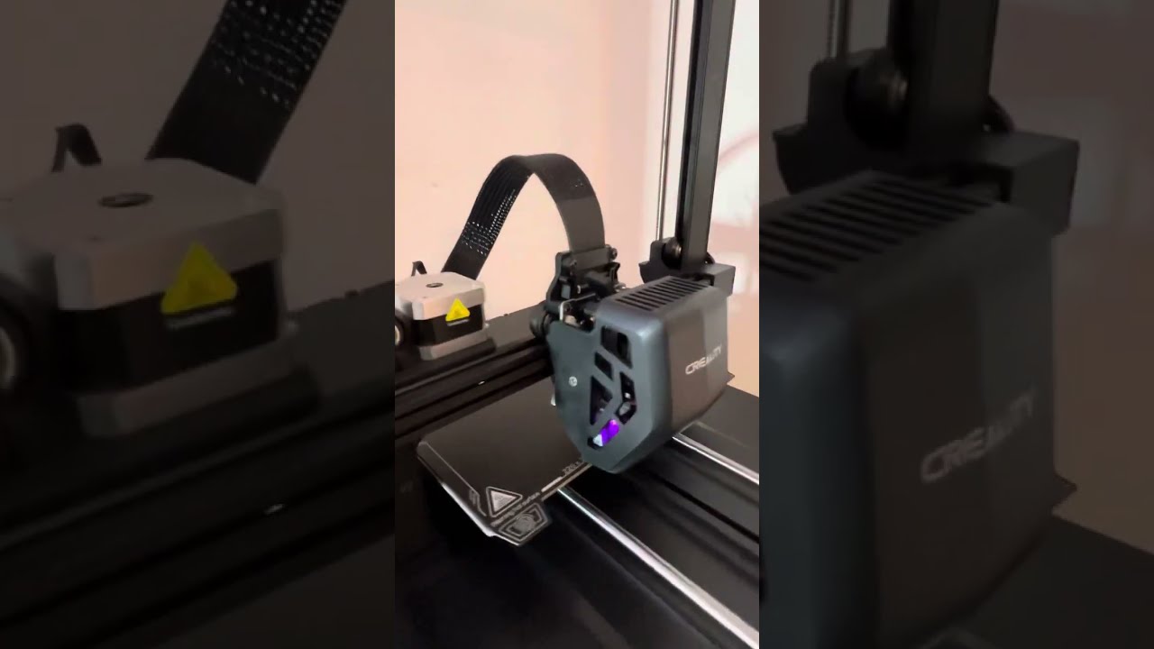

Problem with Ender 3 V3 SE home
@SUPERMAN31170 additional comments:
I pressed the levelling function of my printer and the problem happened again… it didn’t move around the left side at all and collided :frowning:

I bet the x axis limit switch is stuck, making the printer think it’s at the left limit, regardless of where it’s at. Take a close look at that limit switch. With the printer off gently activate it by hand and listen for it to click.
These are the only options that the machine gives me. I can’t modify the home parameters on the screen.
How can I set the X origin? In a slicer software like Cura?
@Denrayr , the bed switch works perfectly but the X switch doesn’t. It’s for sure a problem with the x axis. The problem is that X switch is in the printer head (or extruder) and when I press levelling it doesn’t go to the left side of the x axis. Unless I do what @SUPERMAN31170 suggests (manually moving the extruder to the far left and make it touch the switch) the printer doesn’t do it by its own…
:point_right: Because I can’t upload anything, I did it on youtube so that I can share the link! In the video I’m showing how I manually move the extruder and the bed to their switches
, turn the machine on, auto home, and then go back to the default parameters and finally levelling as usual, and then is when the problem appears. No cuts while filming so it’s a 12 minutes long video so that you can appreciate everything.

On the board side of connectors. Not on the print head. I meant to say X axis limit switch connector.
If you unplugged the X axis motor, why would it drive the Z axis down???
Okay, I found diagrams matching your machine. Unfortunately you only have a Z axis limit switch connector on the board. Bummer! Looks like it runs through the ribbon cable on print head assembly.
I can’t tell in diagram if the limit switch is part of the head assembly or not. The only way to test the switch properly is with an ohm meter. When activated it should zero the meter. When not activated (or when the switch is not pressed) it will read full open if operating properly.
I don’t see anything in your slicer or Gcode that would travel the X axis as far + as it is.
When you manually zero everything like we started and fire up printer, what are the initial readings on that movement screen you took picture of earlier???
Don’t attempt to move anything. Just at manual position and checking the readings on that screen. I can’t find any information of a firmware using that particular screen to show location of axis’. Just a manual movement screen by user.
On the picture you posted, what position are all 3axis’ in?
I think it is in the home position according to where it believes home is. It always moves the print head there everytime I press auto home. The picture I posted , where you can see the values os the axis are also the same . If you turn the machine on, and press “Move” the printer first make an auto home and then you have to press again to “Move” and then you can see the parameters :

The X axis never moves to the left when auto homing
You can see it better in this video

I can definitely hear that x axis switch clicking which usually means they are good, but the next step would be to disassemble the print head to inspect the wiring at the switch. If it looks good I’d check the switch with an ohm meter like previously suggested. After that I’d be digging into the wiring sheet to test the switch pins in the ribbon cable at the control board. If that tests good, I’d make the call that something is wrong with the control board.
To summarize, I Believe the problem is with the controller detecting the state of the x limit switch. These components should all be tested/inspected in this order.
  1. Limit switch.
  2. Limit switch wiring in print head.
  3. Ribbon cable between print head and control board.
If all that is good, then it’s most likely a faulty control board.

I’m still trying to get a reading from all 3 axis’ from him while they’re in home position at zero. All 3 manually at ZERO POSITIONS. But every video/pic he posts is with the X axis beating against the opposite side.
OP, if you’re reading this the X zero position is all the way to the left until it’s on the switch. That’s where I need to see the readings on your screen when you turn printer on. Please don’t hit the homing button again.

After watching the last video I noticed you’re hitting the store settings button. If you do that when the printer is at what it thinks is zero and it isn’t, it will always default to that until you change it. This is why I want to see the readings under (prepare/move) while all 3 axis’ are in proper position.

your ribbon cable seems to be rubbing on the gantry, this could be your problem of the X not homing correctly, as I said earlier I get this on max Z. Solution? manipulate the cable out the way, not a great solution but if it misses the gantry it might home correctly. I put it down as a bit of a design flaw.

Hi @SUPERMAN31170 , I’m back
I’ve followed your steps and there’s one problem:
Even though I don’t want to auto home and just want to know the “Move” parameters of the axis I manually moved to zero when the printer was switched off, It makes the auto home anyways!! That happens every time I press the button “Move” once I first turn the machine on. Then I can look up the parameters and It doesn’t make any auto home anymore…
It’s so weird… there’s no way to know what are the values of the zero axis except this piece of info:
Move X ---- 134.2
Move Y — 125.0
Move Z — 10.0
Extruder — 0.0
Please, check this video I filmed following what you said to me to do:
Hope you can understand what Im saying.
