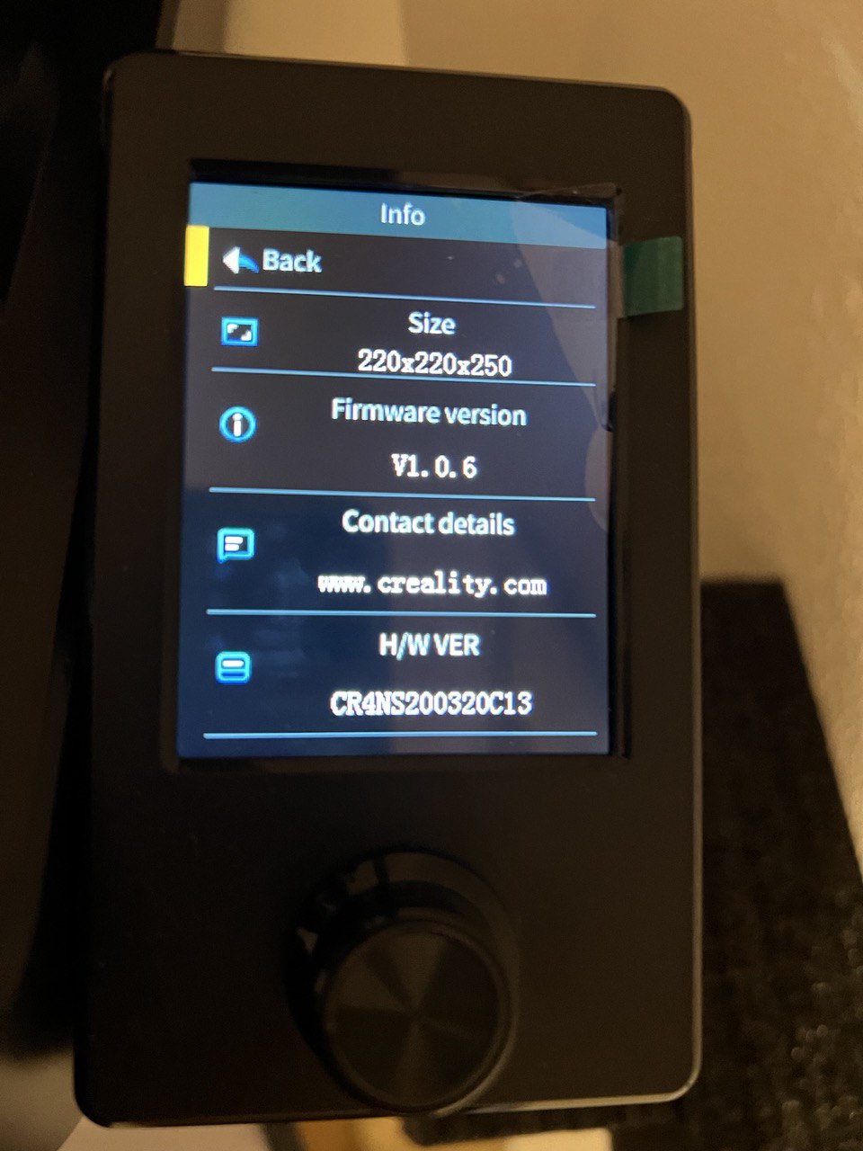

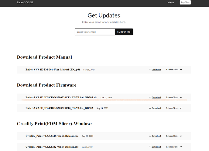

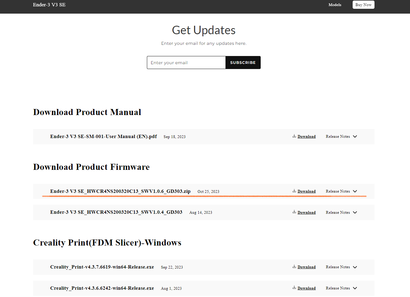

@SUPERMAN31170 , before doing it, I think I have the last version of my firmware…
Actually, when I printed the cat , I had the V1.0.4 firmware, and during the last couple of days the only solution that creality gave was to update de firmware to the V1.0.6
Every tip I tried from you was with the V1.0.6 firmaware… :confused:
Let me know what you think about it, cause maybe you’re telling me other different way to update it

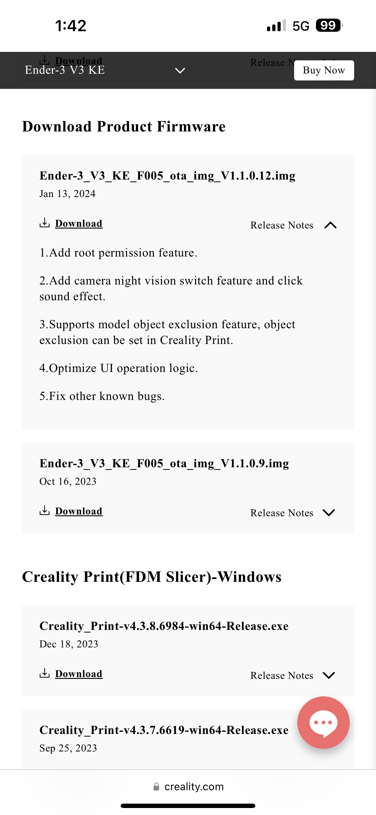

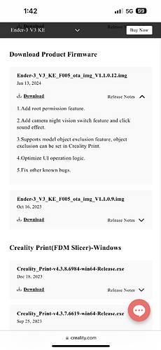

Try the firmware I linked. V1.1blah blah blah is a newer version than 1.0. blah blah blah.
I checked the firmware you have in video’s you posted before I checked all available firmware.
I posted the newest firmware after reading extensively through the whole change/bug fix list. It is supposed to have bug fixes that may be related to your issues.
The version for firmware I linked is only 3 days old.
Linked firmware is for KE, for SE already has the newest.
I saw that, but it’s stated elsewhere that it’s compatible and updated.
Do you or anyone else know if that’s the case by actual use?
I’m going off of information others have said it is compatible and it did help them.
I don’t use either of those models or have immediate access to them to check myself.
I myself use firmware for a completely different machine that implemented many new features and improvements.
The firmware posted is supposed to be able to move all axis’ from the screen manually without auto homing first. Which is what I’m trying to have him do. If so he should be able to set it, save settings and possibly check X axis switch without an ohm meter. He still hasn’t let me know if he has access to one or knows how to use it.
Sorry, but i don’t have any ohmmeter…
If the KE firmware is compatible i’ll give it a try . I’m I bit worried if that can damage my printer or if I is it possible to go back to the V1.0.6 if doesn’t work
