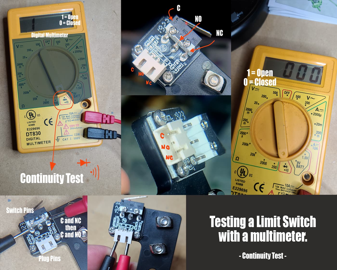

@aquestion29 I have taken the liberty of making this quick reference on how to use a multimeter to test your limit switch(s). Should help backup directions provided by @SUPERMAN31170
You’re doing a continuity test in which the result will reveal whether the switch is functional or not. You can test the switch directly and then test the plug lines as well. For clarification, when I use “1 = open”, I mean that the circuit is broken or open and tjere is no continuity. “0 = Closed” just refers to the circuit being completed and there is solid continuity.
  • Note that polarity doesn’t matter in this test so if you mix up red or black probes when touching the contacts on the switch terminals, have no fear. Also, refer to the post by @SUPERMAN31170 where he tells you what to expect when touching probes to C and NC versus test probes on C and NO. I tested my own limit switch and needed another hand to press the switch while I held the probes to the switch corresponding terminals.

Following the steps I tried 2 functions of the multimeter:
Conclusion → while connecting the pins, the multimeter showed 0 . When pressing the switch , it was 0 or other value. Not sure if I placed the pins correctly but there was no easy way to conect both at the same time while pressing
It seems that all the cables inside the headprinter are ok though…
What do you think guys?

You tested it properly. OHM meter on wrong scale, but it’s fine. Doesn’t really matter that much.
The switch looks fine.
Good to see they are replacing it.
With everything you checked, set and reflashed, it looks like a board issue, or daughter board inside print head. A new machine fixes that.
You went through a pain in the ass, but gained knowledge you may need in the future if you keep at this hobby.
So glad to hear you have been contacted and offered a replacement printer by the support team! Look forward to seeing how things go! :slight_smile:
Looks like you tested the C and NC switch pins and got the correct result when hitting the switch. I would have been interested in seeing the C and NO pins tested also. Sounds like you are getting a replacement printer now so that’s great news! Hopefully you can get started smoothly with the new machine so you can start to enjoy the fun part of the hobby. Troubleshooting your printers will definitely be a skill that you’ll continue to develop. The hope is that you get more printing and less troubleshooting though = )
