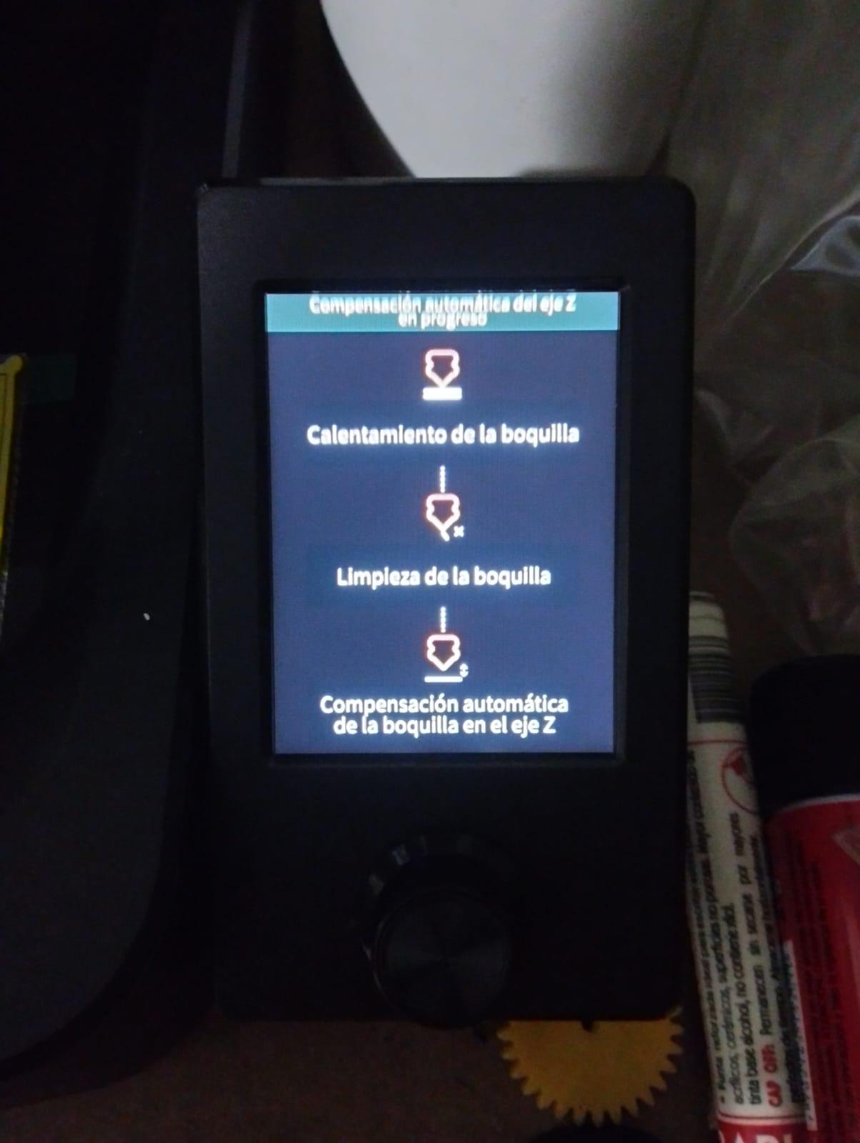

Hello good evening, this seems to be a common problem. On this occasion it is my ender3 v3 se, that has problems when reaching the end of the x-axis as the the motor wants to continue, you hear that the limit switch is actuated when the motor arrives, proble with the multimeter and it is actuated correctly.
The strange thing is that the printer works fine until last night when I went to print a new part and then I noticed the noise and it didn’t work again.
Attached is a video showing what the damage looks like.
