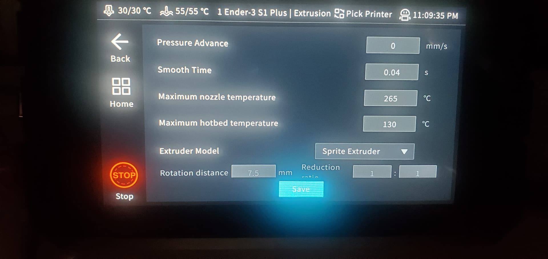

There is the rotation distance setting (configure>advanced options>extrusion configurations) it needs to be somewhere around 8, I think mine was set at 33.363 which meant it under-extruded massively. My V3 SE runs just fine on my Sonic Pad, I have both it and my Ender 5+ running all day. The SE is a little picky about PETG and I really should sit down and calibrate a little more.

HI Bonfireman, that’s a great thing to hear. This isn’t a setting I’ve played with as I would assume the profile should have the correct rotation distance. Would you possibly be willing to check what the exact setting is for you? It would be really amazing to start with a known working value. Perhaps for me this is set too high.
Thank you!
For anyone following this thread in case it’s helpful, my rotation distance is currently set to 7.53 with a ‘Customization’ Extruder Model selected. Pressure Advance set to 0.04 and Smooth time set to 0.04.

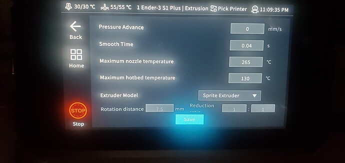

I wanted to do the Extrusion Rotation on my pad that is connected to an Ender 3 S1 Plus but for some reason it is not there. Does something need to be uncommented somewhere or am I one of the lucky ones that don’t have to bother with that?
