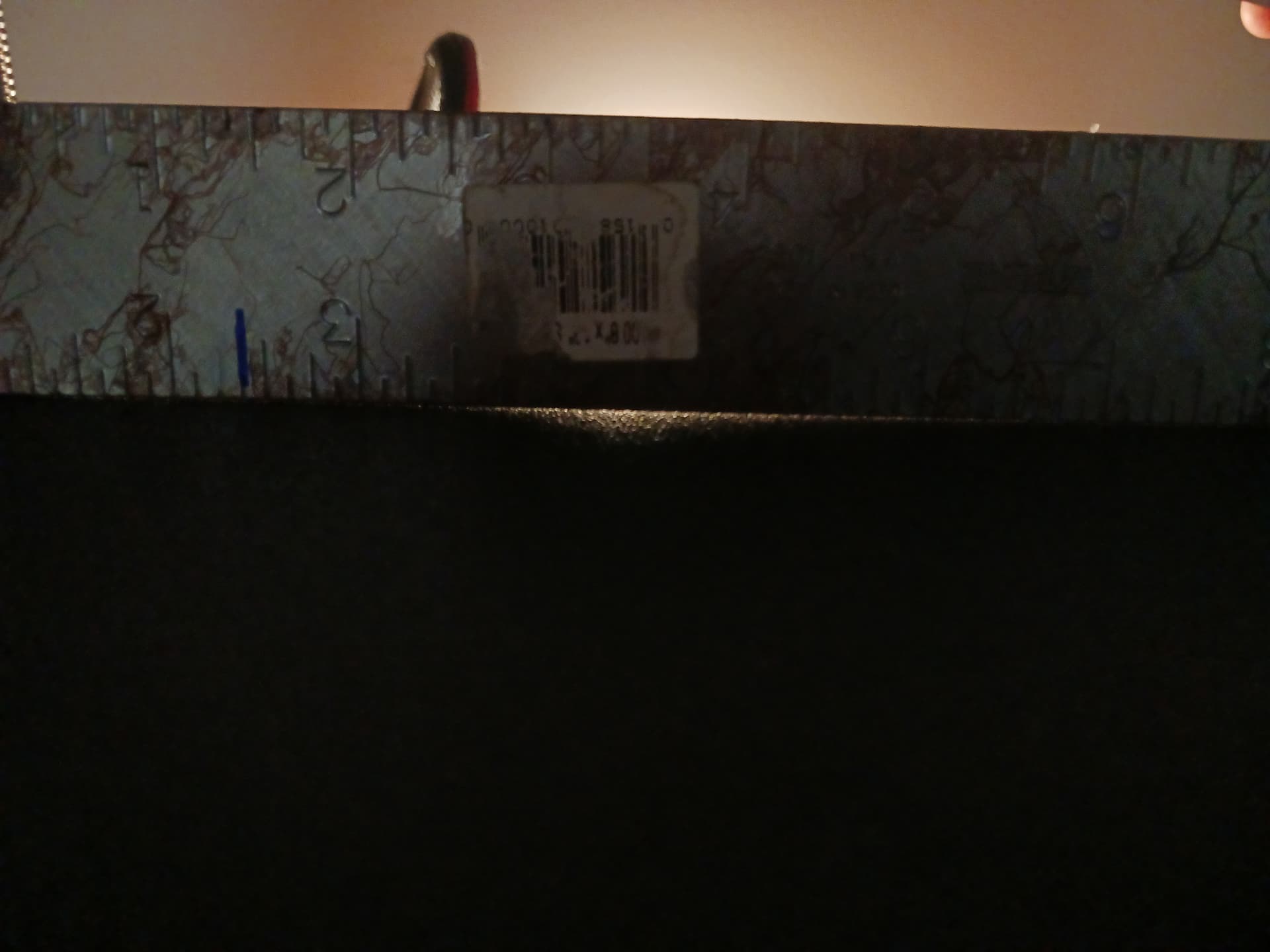

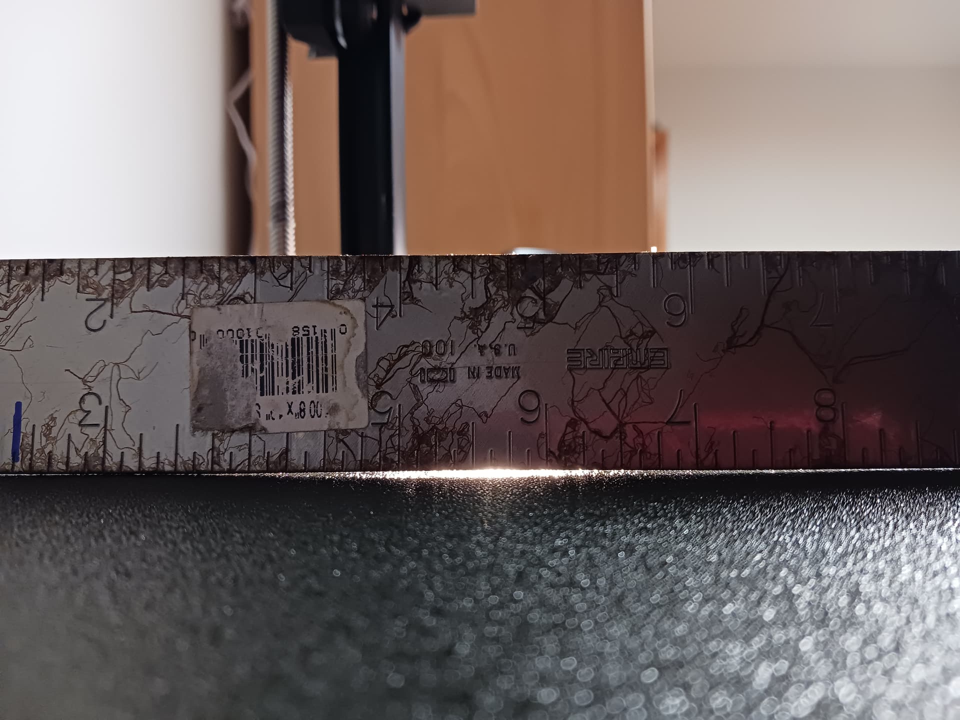

Just a quick tip… do not use a spirit level to level your printer bed, this is not how it works. You should be leveling your bed so that it is level in relation to your gantry and not to the earth.
If you want to check if a bed is warped get a steel rule and place it on the bed on its edge and see if light leaks underneath it.

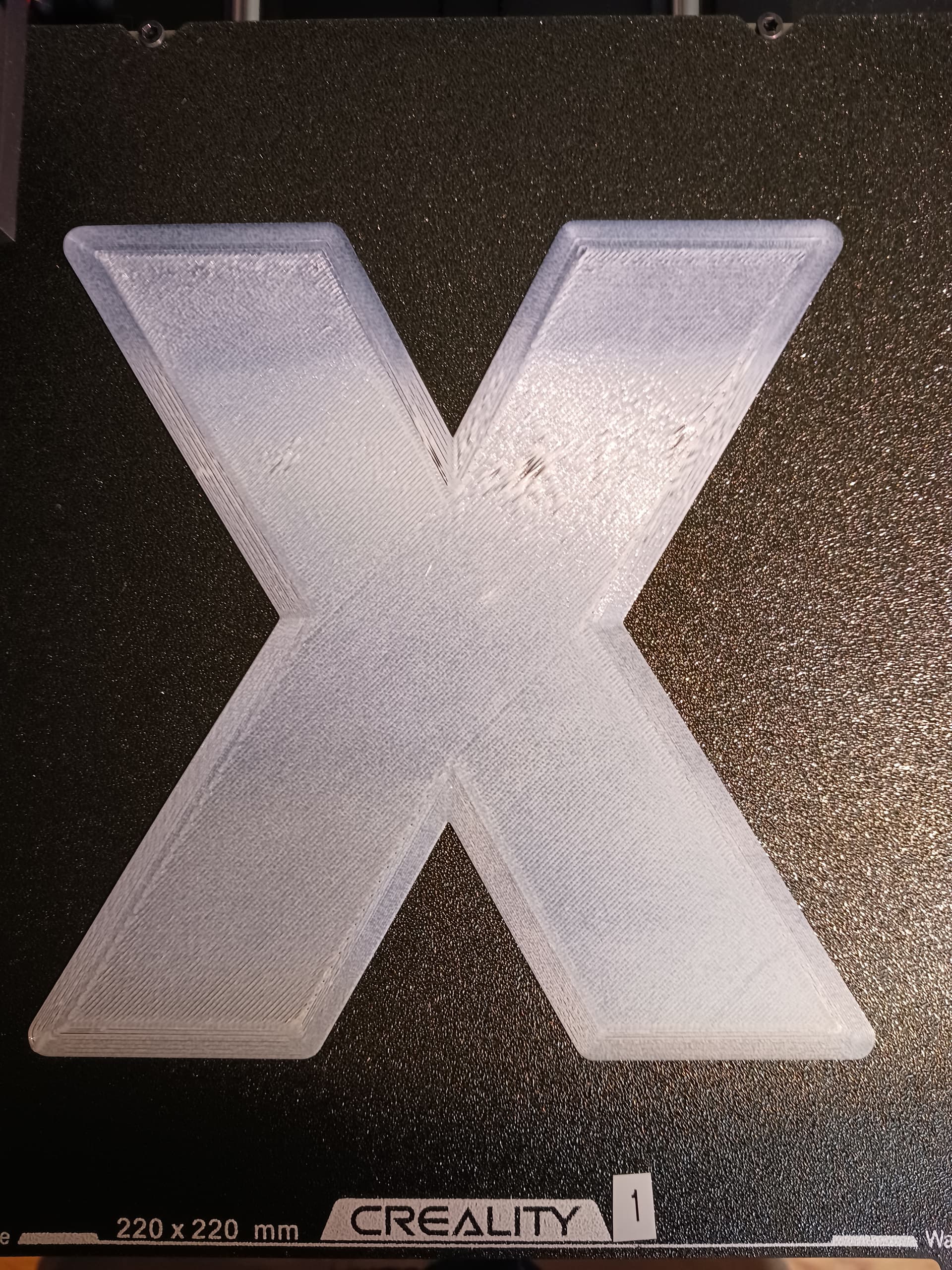

Since I now have two “identical” KE machines I started from scratch. I Auto level & Z, clean beds, same exact (one) filament, same slicer and ran a first layer calibration test. The results pretty much confirmed my suspicions about my original printer which was uneven bed temp of 5-6° and maybe level/warping issues.
Original KE. Note the issue in the upper left and right areas. This directly corresponds with the uneven temps I measured on the bed during printing.
New KE delivered yesterday. This was the very first print and it’s a nearly perfect test. All areas adhered no problem.

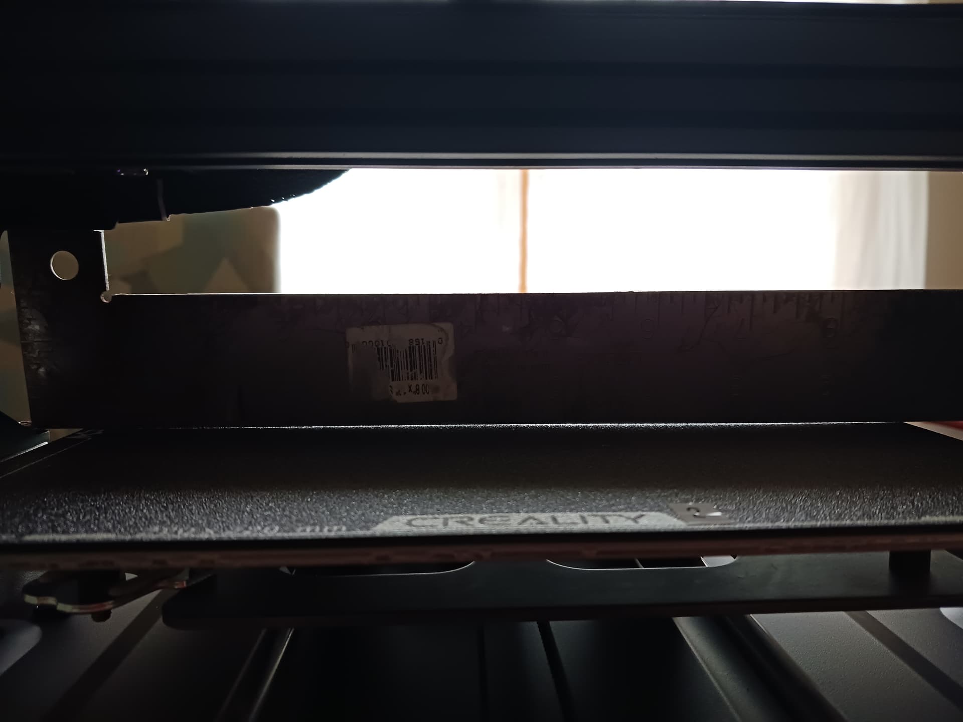

Regarding the beds on both machines:
Both are noticeably warped on the X&Y:
NEW KE X AXIS
OLD KE X AXIS
OLD KE Y AXIS

I think he meant to look under the straight edge to see if there are any gaps, not to make sure it is level.
This will tell you if the bed is bowed - or not

My first layer issues do not seem to be “level” related at all. The auto level and Z adjustments worked just fine on the old printer and of course new one. The problem was demonstrably due to uneven heating of the bed. I did some temperature tests with a infrared gun along with test prints along both the x vs y which confirmed the issue. I also “mirror” printing on both machines. For the record my wife called it “right out of the gate” but I needed to be “thorough” didn’t I?
So far the new printer is quiet, smooth, even heating, level and most important has printed all the first layers with a 100% success rate!
Figuring this out was a great learning experience and I wonder how many other people who experience the same(ish) issues I had have just have an uneven bed heating problem and think it’s due to level and Z?

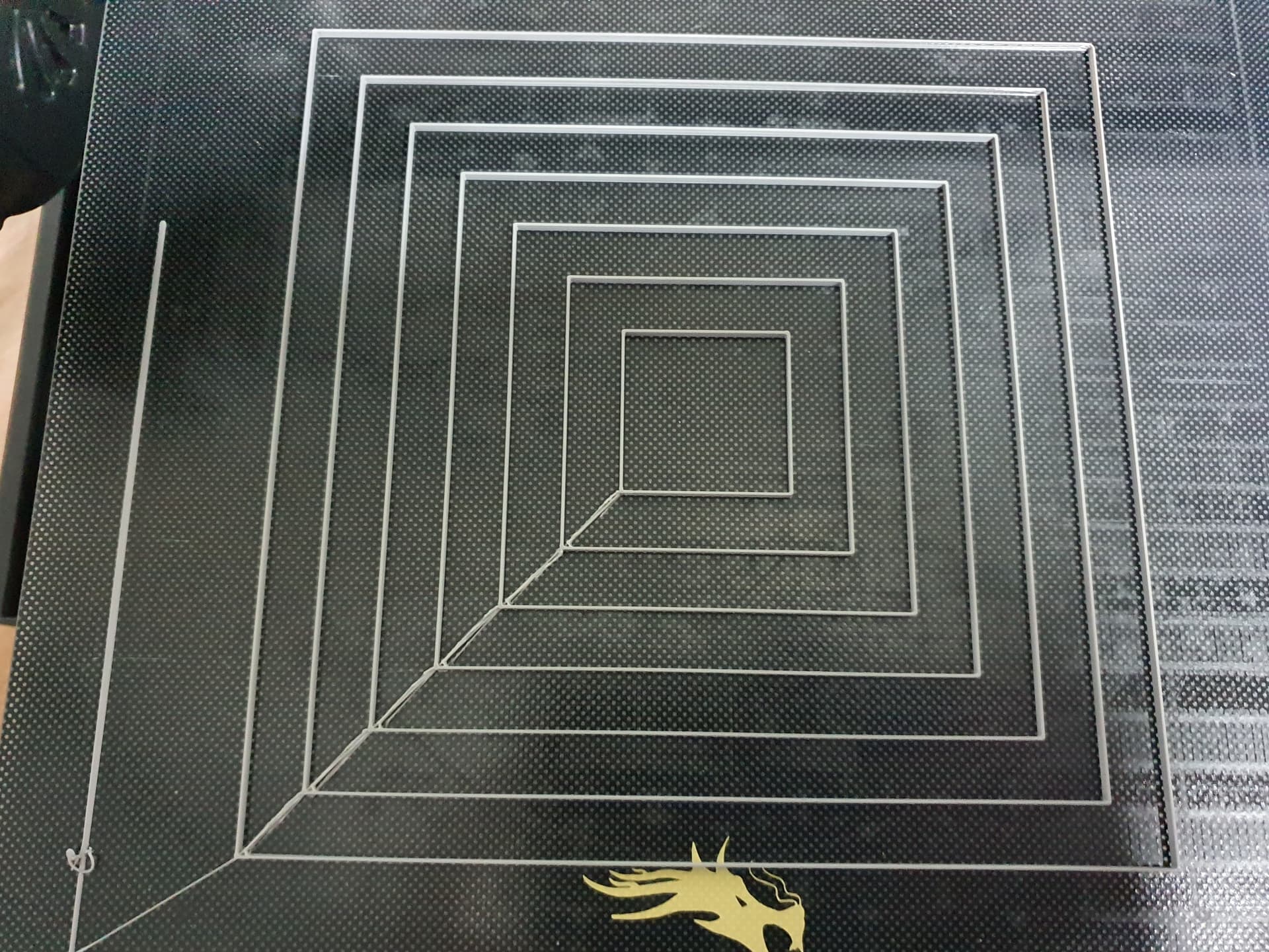

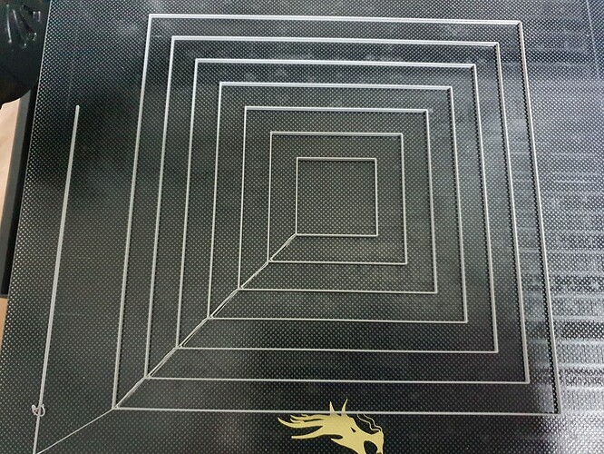

I don’t think the temperatures are the problem. I think it is just dialling in that Z height. The autolevel is pretty good but not perfect. What I do when printing is have a skirt of 3-5 line count, whilst that is printing you should be able to adjust the Z height on the Nebula pad. During the time it prints those you should be able to get it right. Once you find the sweet spot the pad should remember that offset.
find the youtube video from Chep bed levelling. download the bed levelling file.
tune you Z until you get a even print, see attached

I somehow did one of the “best” first layer prints so far, but it still on the left side too close when on the right - to far (see photos below) - and how could it be adjusted without manual bed corner leveling? (in KE there is no leveling knobs on corners) :slight_smile:
